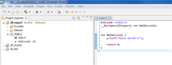

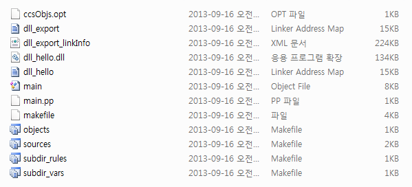

  • I linker option "- dynamic = lib-o dll_hello.dll" have been declared.
    file(dll_hello.dll) has been created.
    Shown below, was to build the source.
    Thus was created to try to use a dynamic link library.
    Other projects (from CCS) will try to use the library.
    Below as the source of a dynamic link library using the "hello, world" I want to output.
    However, the I do not know how to use the dll file.(How to Link???)
