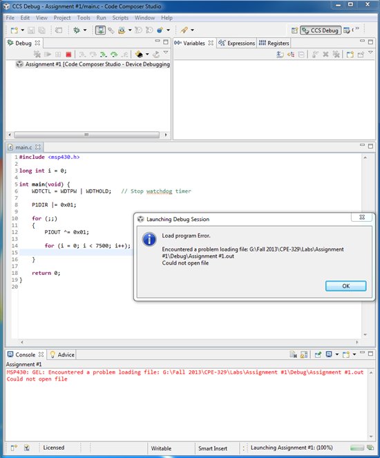

I am simply just trying to debug code I've written to blink an LED on a TI Launcphad MSP430G controller.  A pop-up apperas with the following text when I'm trying to debug:
Load program Error.
Encountered a problem loading file G:\Filepath\File.out.  Could not open file.
The CDT Build Console outputs the following:
**** Build of configuration Debug for project Assignment #1 ****
"C:\\Program Files\\TI\\ccsv5\\utils\\bin\\gmake" -k all
makefile:115: *** missing separator. Stop.
**** Build Finished ****

  • The code is also shown in the screenshot.  It is from the Blinking LED tutorial available on the online wiki.
  • You are getting a "load program" error because your build failed and the program was never generated. Hence the debugger can't find the program. You need to resolve you build error.

    If the build did fail, then why would the CDT console output that the build finished?  The first post on this thread contains the ouput of the console when I try to debug the C file I attached to this post (it is the same C code from the screenshot above).
    It's a bit misleading. Basically the build action finished completing and the result was a failure.
    It's not the C file that is needed but your whole project folder. And also provide what exact version of CCS you are using and what version of the build tools.

  • I think I found the problem.  My project name had a pound sign in it - I guess CCS doesn't like that because I can now upload my code onto my launchpad
  • Good to know you found the issue.
