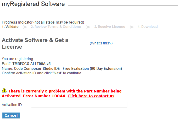

I installed CCS 5.5 and Control Suite. Now the Problem is to get a license to work with.
This error comes when I want to get a license for CCS 5.
I got a free license for CCS V4.2. Can it be a problem to get a new license for CCS 5?

Please contact the CCS Licensing team for help with this, their email is: ccs_license_file_help@list.ti.com
Hi Daniel,
what problems do you experience? In v5 there is no code size limited c2000 license. However the xds100 is free to use with ccs. Are you using an xds100? (Help->Code Composer studio Licensing information->upgrade tab and "launch license setup". You want the free limited license.
If not you need to upgrade to a v5 license (if your subscription is active - the advice from my colleague points to the correct info for help there) or buy one.
