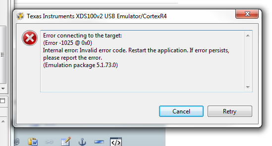

Error connecting to the target: (Error -1025 @ 0x0)
Other Parts Discussed in Thread: TMS570LS1227, UNIFLASH
Having this error message while trying and failing to flash a TMS570LS1227 MCU using Unflash tool version  2.2.0.00016
It says error is unknown and must be reported to Ti support...

  • Well, before running extra investigation, I suggest to some the first question : how can I update uniflash tool in order to find the TMS570LSxxxx into the list of supported devices ?
    I'm installing CCS right now...
  • Vincent,
    Okay I thought this was some other emulation error, but it seems we don't even have the device on ti.com catalog, so there is no support for it. Is this an old device?
    Victor
  • No, it is a new device used for a new mass market automotive project...
    Printed reference is TMP570LSxxxx

  • Here is the log file of the Connection Test feature.
    I do feel the hardware chain is working fine, what about you ?
    I believe we may just have this issue due to the wrong device file, right ?
    Vincent

  • Yeah this shows the scan chain is good.
    However because we don't have the right device files it would fail when trying to setup a connection to the target core.
    Hopefully all we need is the right device files. We would need to confirm with the BU on this.

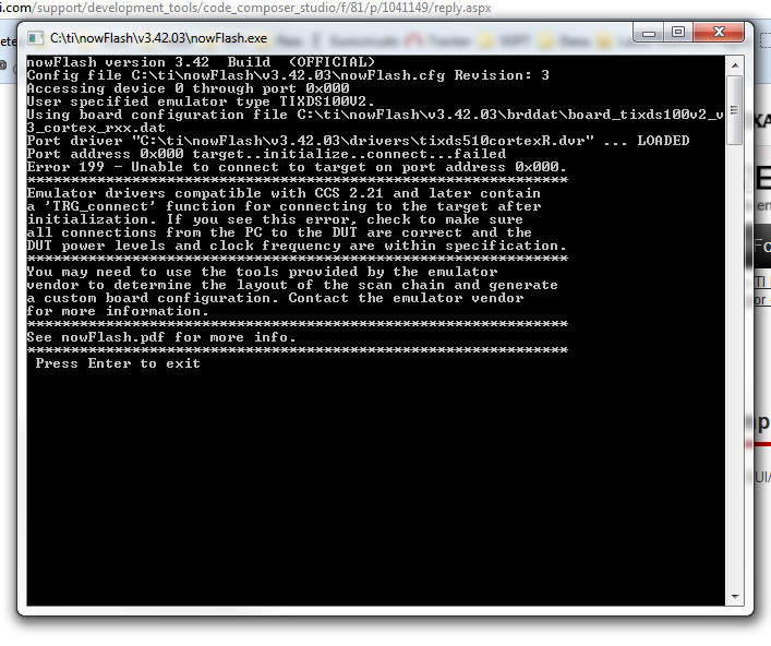

  • Thank You John,
    Just talked with our local TI contact.
    Something I need to explain : I also tried to flash using the NowFlash Tool but it fails too.
    That tool was provided to me with a customized cfg file including theTMS570LS31xx settings.
    But unfortunately the tool fails to connect without being so clear about the failure.
    Maybe we should try make this one working, because this works at the dev team side.
    Here are the details :
    Now flash version v3.42.03
    Custom NowFlash CFg file :
    6675.nowFlash.cfg
    Used command line :
    -bl -er -pr -ve  "E:.....\PBL_with_ecc.s37" -d -q -emu TIXDS100V2 -p 000 -cpu CORTEX_RXX -targets 1
  • Vincent,
    Modify your command line with -d after -ve.  That enables more verbose output.
    Also, what board are you connecting to?
  • Hello John,
    The -d option is already set in the captured sequence.
    I'm running with a basic XDS100v2
