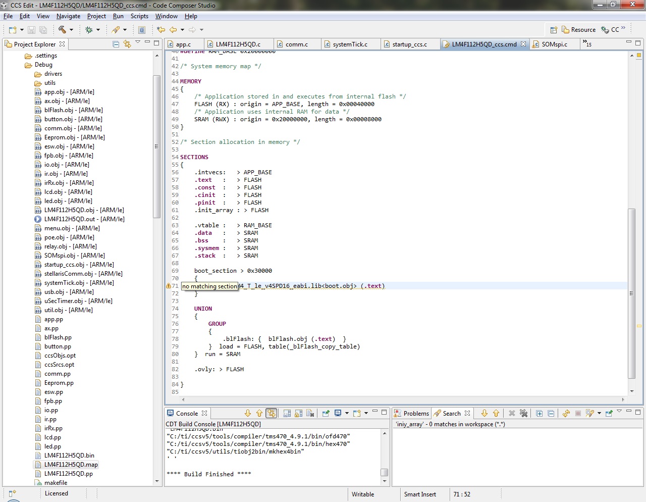

     I modified my file but it didn't work.  I got this warning:
    "No matching section."
    Here is the snippet of code from the .cmd file.  I'm sure I did something wrong but don't know what.

  • The name of the library is rtsv7M4_T_le_v4SPD16_eabi.lib.  I don't know why it was underlined above.  So the exact line I have in my file is:
    -l rtsv7M4_T_le_v4SPD16_eabi.lib<boot.obj>(.text)
    I found where the section on the linker "Specifying Library or Archive Members as Input to Output Sections" and it uses and equal sign after the -l:
    -l=rtsv7M4_T_le_v4SPD16_eabi.lib<boot.obj>(.text)
    I tried this but it didn't work either.  I have attached a screen shot of the warning.
    Susie

  • From the build console:
    'Invoking: TMS470 Linker'
    "C:/ti/ccsv5/tools/compiler/tms470_4.9.1/bin/cl470" -mv7M4 --code_state=16 --float_support=FPv4SPD16 --abi=eabi -me -g --gcc --define=ccs --define=PART_LM4F232H5QD --define=TARGET_IS_BLIZZARD_RA1 --diag_warning=225 --gen_func_subsections=on --ual -z --stack_size=9216 -m"LM4F112H5QD.map" --heap_size=0 -i"C:/ti/ccsv5/tools/compiler/tms470_4.9.1/lib" -i"C:/ti/ccsv5/tools/compiler/tms470_4.9.1/include" --reread_libs --warn_sections --rom_model -o "LM4F112H5QD.out"  "./util.obj" "./usb.obj" "./uSecTimer.obj" "./systemTick.obj" "./stellarisComm.obj" "./startup_ccs.obj" "./relay.obj" "./poe.obj" "./menu.obj" "./led.obj" "./lcd.obj" "./irRx.obj" "./ir.obj" "./io.obj" "./fpb.obj" "./esw.obj" "./comm.obj" "./button.obj" "./blFlash.obj" "./ax.obj" "./app.obj" "./SOMspi.obj" "./LM4F112H5QD.obj" "./Eeprom.obj" -l"libc.a" -l"C:/StellarisWare/boards/ek-lm4f232/hello/ccs/../../../../driverlib/ccs-cm4f/Debug/driverlib-cm4f.lib" -l"C:/StellarisWare/boards/ek-lm4f232/hello/ccs/../../../../grlib/ccs-cm4f/Debug/grlib-cm4f.lib" "../LM4F112H5QD_ccs.cmd"
    <Linking>
    "../LM4F112H5QD_ccs.cmd", line 58: warning: no matching section
    Zipped .map file:
    4760.LM4F112H5QD.zip
    Susie
