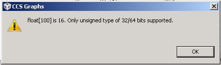

  • Hi Gautam,
    I tried plotting graph of the RMS array, which is float32 in CCS. But I get an error float is 16. Only unsigned type 32/64 bits are supported. Please find attached.
    I tried selecting the complete array of 100 and then  copy paste in excel, but only top 3 values are pasted in excel. I also tried import option in the expression window but can't get the values. Separate post on  http://e2e.ti.com/support/development_tools/code_composer_studio/f/81/t/298866.aspx
    Thank you for the link, I will have a read through real-time mode.
