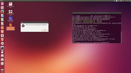

Hi TI and fellow Engineers,
I am having difficulty in getting CCS installed on a fresh Ubuntu 13.10 32-Bit base. Following the instructions on the TI website does not seem to help and some of the dependent packages they list don't seem to exist.
Running the dependency check script does not populate the ext-depends.txt file, so I assume I have all the dependencies.
I am using the offline installer and once complete it places 4 icons on my Desktop, trying to run the CCS shortcut results in an error message, see attached screenshot.
Any help appreciated.
Rgds,
Thilina
  • Hi Thilina,
    It looks like your desktop link was either created incorrectly. Can you try launching the application from the installation directly? For example, if you installed CCS in the default location as a regular user, it would be in $HOME/ccsv5/eclipse/ccstudio.
    Danish
  • Thilina,
    Just adding to Danish's reply, check this thread that talks about how to enable the correct ownership permissions for the icon.
    Rafael
  • Hi Danish
    As I ran the install as sudo, it was in the /opt/ti directory. I did as you said and CCS loaded. However after closing CCS it errors, see the workspace error file attached.

    	at com.ti.ccstudio.internal.resource.explorer.ResourceExplorerUtils.getContributionInputPaths(ResourceExplorerUtils.java:417)
    	at com.ti.ccstudio.internal.resource.explorer.ResourceInputProvider.init(ResourceInputProvider.java:93)
    	at com.ti.ccstudio.internal.resource.explorer.ResourceInputProvider.<init>(ResourceInputProvider.java:82)
    	at com.ti.ccstudio.internal.resource.explorer.ResourceInputProvider.<clinit>(ResourceInputProvider.java:76)
    	... 3 more

  • Hi Rafael,
    Your method works, by changing permissions and running I am not getting the error. Also the rror I was seeing after running CCS is no longer occuring.
    Many Thanks,
    Thilina
