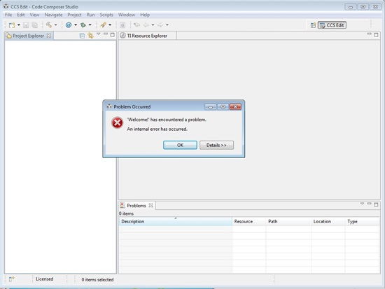

  • Ki,
    Ok tried what you suggest and it generated an error (see image below), I tried again with a different folder and also creating a new folder but same issue.

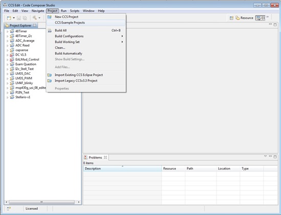

  • I tried other as you suggested and  CCS restarted and opened with everything blank but no TI explorer window showing, so I opened TI explorer via Project/CCS Example projects, this opened TI Explorer with the same issue.
    I did the same as above but browsed to a different location and created a new folder, then did the same as above and then the error appeared.
  • Please reproduce the error and then provide the Eclipse Error Log (you can attach it here)
    http://processors.wiki.ti.com/index.php/Troubleshooting_CCSv5#CCS_Diagnostic_Logs
    ki
  • Hi Ki,
    Log file attached as a txt file below:

    Ant
  • Hi Ant,
    From the log file, it looks like you have missing dependent library file. Can you check if this file exist on your PC?C:\ti\ccsv5\eclipse\plugins\com.ti.chromium.browser.win32.win32.x86_1.0.0.201308270800\libs\Cef3Wrapper.dll
    If this file exist, can you also verify its dependent libraries are also available on your PC? You can download this utility from here http://www.dependencywalker.com/ to walk through all the depended libraries.
    Patrick
  • Hi Patrick,
    I ended up re-installing CCS.  I have had a few issues with CCS now on 3 different computers (2 laptops and 1 desktop), and re-installing seems a full proof, but lengthy way to resolve issues.
    I am in a class with about 15 people and everyone seems to have issues with CCS, there is one guy who has 15 years of programming experience.  He says the issue is Eclipse as it has under lying bugs which have been unresolved for many years.  I guess it's freeware and you cannot complain, but I certainly wouldn't pay for CCS in it's present form.
    Ant
