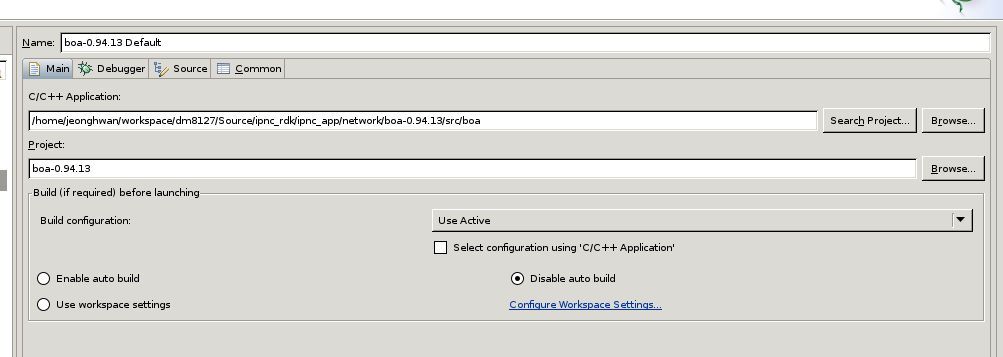

  • below are Boa debugging steps with CCS v5 .
    1. import boa webserver sources as a  makefile project
    2. remote debug setup as follows ,  using GDB Manual Remote Debugging Launcher

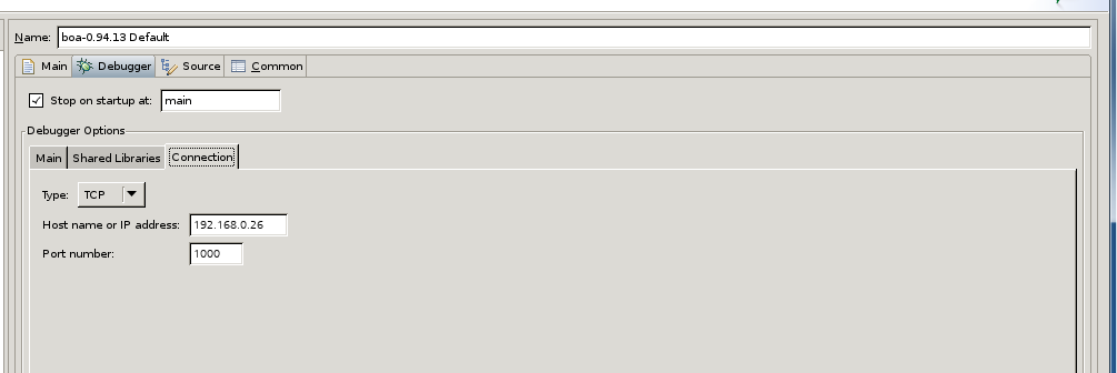

  • the .gdbinit file often defines sysroot, which is needed to have debug visibility of the shared libraries. I see in your third screenshot that you did specify a location for .gdbinit, just left the default name. Do you have a .gdbinit file and does it define sysroot?
    ki

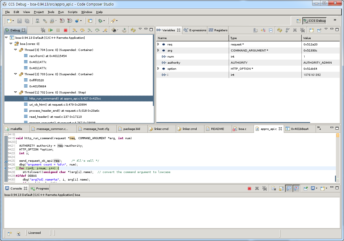

    Thanks Ki .
    It works now.
    I made a mistake.  I had forgotten to copy the last boa debug binary to dm8127 .
    As you noted  , I corrected .gdbinit path setting .

    When a CCS gdb starts ,  it breaks Main function because a  remote GDB setting  was configured as "STOP on startup at main '.  So to run a program , continue command should be entered .
    You can refer remote GDB setting in the same posting .
