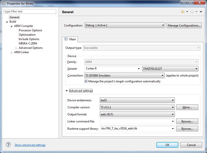

I'm trying to create a program for my TMX570LS1227ZWT, but I'm having trouble creating the program file in CCS because I get the following error in the targetConfigs folder:
schema_reference.4: Failed to read schema document 'file:/C:/ti/ccsv5/ccs_base/common/targetdb/setup_parser.xsd', because 1) could not find the document; 2) the document could not be read; 3) the root element of the document is not <xsd:schema>. in file C:/Users/x0207945/ti/myWorkspace/CCS/Blinky/targetConfigs/TMS570LS1227.ccxml
I've tried looking for the missing file in the directory, but it's not there.
Here is my setup of the project:
Can anybody please tell me what I'm doing wrong"? Thanks

    What is the full version number of you CCSv5 installation? And did you install all the components for Hercules?
    Also I see you are trying to use the TI XDS560 PCI emulator. Did you make sure you installed the drivers for it? They don't get installed by default.

    I got the problem fixed briefly when I deleted all the ccs files from my computer and did a full uninstall and then reinstall. However, I've come to a new problem. Whenever I try to launch the CCS software, I get the following error.
    "An error has occurred. See the log file
    C:\Users\x0207945\ti\myWorkspace\.metadata\.log."
    I've actually run into this problem before, and I solved it that time by uninstalling and reinstalling CCS. However, this problem occurred again, so I'm wondering if there's a more permanent fix.
    Here is the log file
    6318..log
  • Thanks for the log. i will get it analyzed.
    In the meantime, try using a new workspace folder if you are having issues starting CCS and see if that helps
