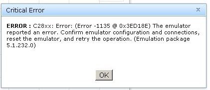

I am getting the following message on the CCS console intermittently (every two or three hours) while running my program on my custom F28069 target board with CCS 5.5:
C28xx: Error: (Error 1135 @ 0x3ED18E) The emulator reported an error. Confirm emulator configuration and connections, reset the emulator, and retry the operation. (Emulation package 5.1.232.0)
C28xx: Unable to determine target status after 20 attempts
The GUI also shows the message:

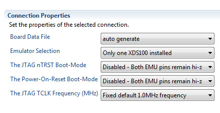

2. My F28069_custom.ccxml target configuration uses Connection: Texas Instruments Xds100v2 USB Emulator, and Board or Device: TMS320F28069.   The Jtag is set for running Jtag at 1.0MHz.
The DbgJtag integrity test runs successfully.

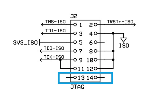

  • Please see attached file which contains the portion of the schematic with the Jtag header to F28069 interface.
    Gordon
    4213.PortionOfCustomF28069Schematic.pdf
  • Gordon,
    I don't see any changes to suggest hardware-wise.

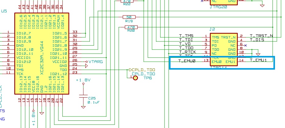

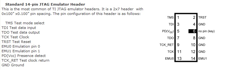

    I have questions related to JTAG 14-pins connection.
    I see that XDS100 emulator with 14-pins has this pins connection based on http://www.blackhawk-dsp.com/jtag.aspx
    And based on XDSv2 schematic:
    And in Gordon's schematic, it was:
    But in TMDSHVMTRINSPIN, it was:
    And in another schematic (experimenter kit), I saw that pin 13 and pin 14 were connected to EMU0 and EMU1.
    I think XDS100 doesn't use EMU0 and EMU1. So should I pull them up like Gordon't way or just let the pins NC?
    Which one that the best connection for TMDSEMU100v2U-14T in this case?
    Also, should I leave pin 6 to be NC? Or in Gordon's case, it was connected to GND. Is it OK?

  • Maria,
    Sorry for the late response.
    Pin6: Pin 6 of the 2x7 header should be cut.  Because of this, it doesn't actually matter how it is connected schematic-wise.
    Pin13&14: On Piccolo devices, having NC should be adequate (because there is no EMU0/EMU1 connection on the chip itself).  On many other devices, EMU0/EMU1 is used and should have a pull-up.
    Thank you,
    Brett
  • Brett:
    I still don't know what Error code -1135 means. DbgJtag only lists the messages associated with errors -1 to -999.
    Also, regarding having up-to-date drivers, are you referring to FTDI drivers which are bundled with CCS 5.5?
    And do you have an explanation for why there is no issue with XDS100v2 built into Piccolo ControlStick F28069, but there is an issue with a separate XDS100v2 emulator when used with our custom board. The XDS100v2 device driver is the same for both target configurations.
    Gord
  • Gord,
    From what I have seen Error -1135 is a fairly generic error staying that connectivity was lost.  I haven't ever seen a good description of Error -1135 myself.

  • Hello Brett,
    Thanks a lot for the answer.
    In this case Gordon uses piccolo, but in his schematic, he pulled-up these pin 13&14, will it influence the emulating process or not?

  • Maria,
    From my understanding, having pull-ups on pin 13 & 14 shouldn't change the way the emulator operates on Piccolo devices.
