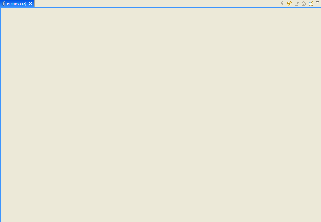

I am using code composer v4 with the TMDSPREX28335. When I open the memory window, though, it is grayed out. I cannot see any data in the memory. When running, the register values in the watch window are OK.
What seems to be the problem?
The first thing I would suggest trying is resetting your perspective and cleaning your workspace:
http://processors.wiki.ti.com/index.php/Troubleshooting_CCSv4#General_IDE
You may also want to take a look at this thread in case your symptom is similar, although your memory view does not seem to have the address field at all. Hopefully one of these suggestions will help resolve the issue.
As a side note, CCSv4 is pretty old so I would suggest updating to CCSv5 as soon as it is practically feasible for you.
