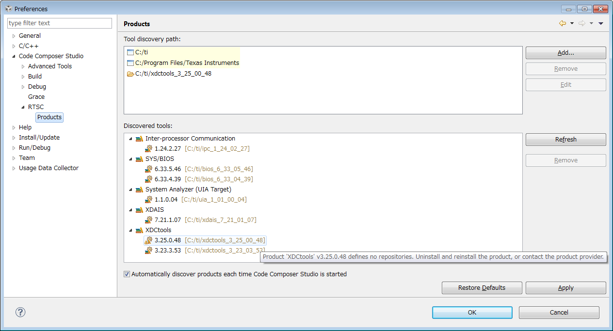

I'm having problems XDCtool is not recognized well in CCS.
Environment you are using are as follows.
・CCS : Verison 5.2.0.00069
・XDCTools : Version 3.25.0.48
・SYS/BIOS : Verison 6.33.5.46
Install the XDCTools,
Windows -> Preferences -> RTSC -> Products
While trying to add an item of XDCtools,
Surprised mark with the version of 3.25.0.48 like the attached
You are currently not well recognized.
Is it all right if you take like any correspondence to use?
