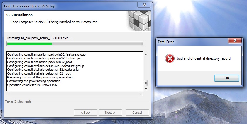

there is some installation error .
it says to have a look at logC:/ProgramFiles/InstallJammerRejistry/ccv5/605565E5-C1A1-4061-8DF8-FFB8393BAE2D/ccs_setup 5.5.0.00077_install.log for more information.
i have already disabled anti-virus

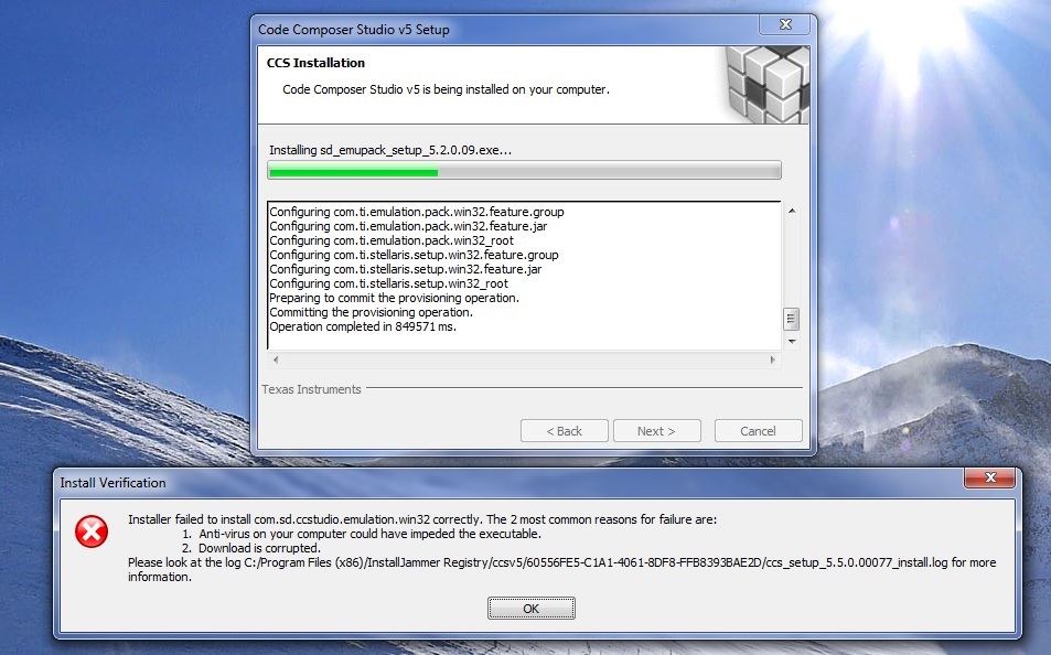

Same error here.
This posting tool will not let me put the details in(too large).
6283.0184.5287.20131119-082023.ccs_setup_5.5.0.00077_install.zip
log file..
The install log contains several network failures. I suspect something was corrupted during the download of this particular install package despite the retries I can see in the log. My suggestion would be use the large ZIP download instead of the web installer. Since the ZIP download has a CRC it would be easier to tell the content was downloaded correctly.

The large non-web installer worked great.
