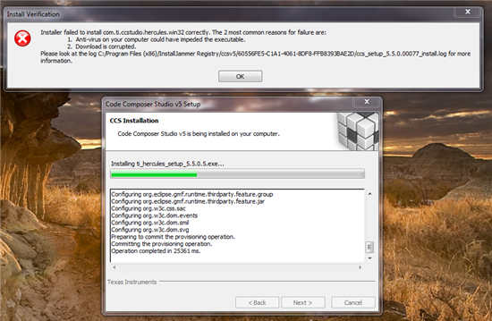

I am trying to install Code Composer Studio v5.5 on my computer, but I can't get it to finish the installation. It always gives me this same error.
I'm using the offline installation (I also tried the web installer). I'll upload the installation log.
Please help!
Hi Diego,
Try the following:
Disable firewall also and then new installation to directory with short path "C:\tinew" through right click on the setup.exe file and click on "Run as Administrator".
If still you face any issue try downloading the CCS v5.5 setup.exe again.
Gautam
Hello. Thanks for the reply!
I tried what you said. I disabled both the antivirus and the firewall and I had no luck. I tried both the offline and the web installer and it gave me the same error. Any other advise? Here is the new install log. Thank you very much!
Yes, I did. I even downloaded the CCSv5.4 and the CCSv6 beta with no luck. I will try to install it on a clean virtual machine to see if my error has something to my windows installation. Thank you!
Well, I managed to install it under safe mode. I also was able to install it in one of the computers in the lab of the university. Thanks for the support!
