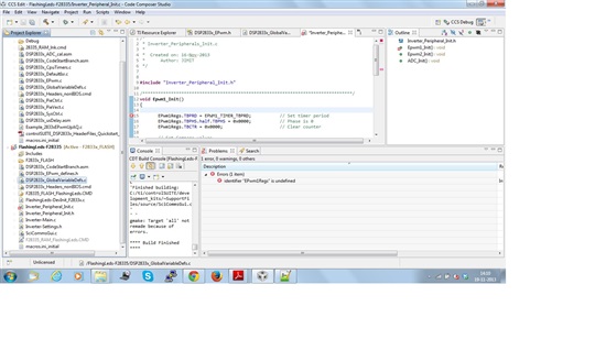

I am trying to set up a new project in CCS5 based on the 28335 processor.
To get started, I simply copied the FlashingLeds project in to a new folder called "Inverter_V2" located in the controlSuite at C:\ti\controlSUITE\development_kits\TemplateProjects\FlashingLeds-F28335_v1.0.
The folder "Inverter_V2" is located at the same location i.e. C:\ti\controlSUITE\development_kits\TemplateProjects
Then  I imported this in CCS5 and gave a build. It works fine till this stage.
After this, I included some of my project specific files related to EPWM initialization. However, As soon as I do that, it throws up an error saying "identifier Epwm1Regs is undefined"
I have  included the file "DSP2833x_GlobalVariableDefs.c" where these Register names have been defined and yet I get an error.
Can someone please take a look and suggest some solutions?

  • Wait......you do have that file in your project.
    Did you forget to hash include "DSP2833x_EPwm.h"?
    Stephen

  • Hello Stephen,
    Yes, I guess that's it!
    I didn't include the DSP2833xx_Epwm.h file.
    I shall include it, check and revert back. But I am pretty sure that's the issue.
    Thanks a lot,
    Jimit.
  • Hi Stephen,
    I have confirmed that the problem was due to the missing header file.
    Jimit.
