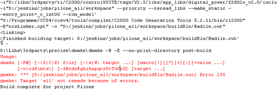

I'm using the CCSv4.2.3.00004. I'have now a problem in the post-build steps (see print screen).The project compiles on my machine but if I compile the project on another machine it fails.
It would be helpfull if I had some more information during the post-build steps. Is there a way to enable a print out of the post build steps?

    Here the print screen that doesn't come with my first post:
    An here you find the console output of the working one:
    The CCS version is the same on both PCs.
    The target is the TMS320F28023.
    A difference I have is the operating system, Win7 is okay, XP has the failure. But I guess it's not the operating system where the error comes from.
    I'm using SVN. The project is so moved by the svn server, with a fresh checkout at first and later by updates.
    Today I checked the environment variables. Because we are wondering about the different calls (gmake or dmake). On the failing machine XDStool were installed and because of that the path environment variable is set to "%XDCROOT%". What I will try is to remove this entry. Where are this different gmake or dmake calls (see printscreens) coming from?

    If you study the printscreens above one difference looks intresting. Last cmd before error appear is different. But this command is called from CCS I guess I can't influence it.
    Ok one has:
    D:/Programme/CCS4/ccsv4/utils/gmake/gmake --no-print-directory post-build
    Failde one has:
    D:\Libs\3rdparty\precise\dmake\dmake -B -E --no-print-directory post-build
    Matt

  • What I want to know is where is dmake being called from. It's not CCS. There must be some post build step but I don't see it in your screenshot.
  • This dmake call is in fact strange. You say it's not coming from CCS, but I have no idea where it then should come from. I have on this machine other CCS projects that do work, also with post-buld-steps.
    Could it come from a defect project file?
    What would you recommend to do (set up completly new project, ...)? Any Idea?
