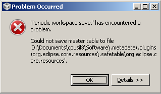

Yesterday I tried commiting my work and right after that CCS comes up with the error in the attached file. It's running on Windows 7 and this error has never happened before.
  • Does it provide any additional information when you click on details?  It is possible that cleaning the workspace might help.  You could start ccs from the command prompt with the -clean option "ccstudio.exe -clean"
