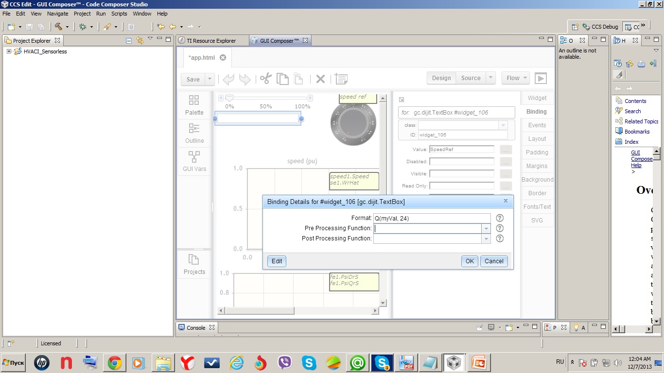

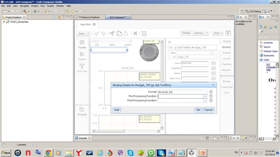

    1- i have the current of the ACI motor. it is a sine wave. it is q value is q24. when i tried to plot in the GUI  it is not appierd as sine wave. in the ccs, and for plot it, by using the datalog[1] feature to store the values in a memory buffer. can you help to do it for gui? how can i put sine wave data points into an array on the target side?
    2- for convert the data to appear in gui as q24 i dieveded the vales in app.js fuunction divideTenthousand and times in function timesTenthousand! value / or * 16777216? it is right?
    3- how can i exite run time for c2000; in wiki
    Assuming that you have an array of 5000 elements, each element is a point on the x-axis. The value of the array element represents the y-axis. So, you will need to store your data points (y-axis) into the array. On the host side, GUI Composer, you will need to bind this array to the Series Value in the Binding tab.
    Watch this video to find out how to bind variables in GUI Composer.
    http://software-dl.ti.com/dsps/dsps_public_sw/sdo_ccstudio/guicomposer/gc_intro/gc_intro.html
    See this post for q-value binding.
    http://e2e.ti.com/support/development_tools/code_composer_studio/f/81/p/295399/1030118.aspx#1030118

    ahmed diab said:
    2- for q24 please check the print screen!! this is true to read with the q24. thanks
    I found out that we don't currently support Q-value for array binding at the moment. You will need to use the pre and post functions to do your conversion.

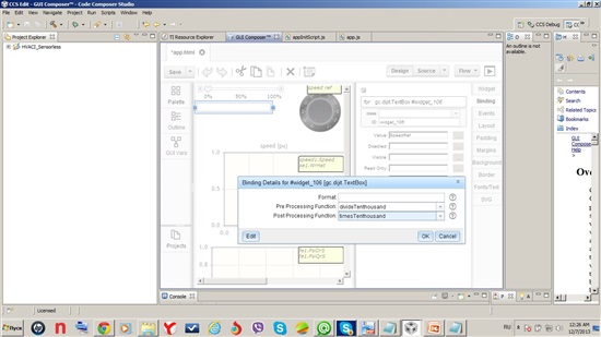

    dear; sorry but it is very important for me!
    1- please see the app.jas and the printscreen and this to convert from and to q24?
    Fullscreen 4130.app.txt Download
     * This file is provided for custom JavaScript logic that your HTML files might need.
     * GUI Composer includes this JavaScript file by default within HTML pages authored in GUI Composer.
    require(["dojo/ready"], function(ready){
         ready(function(){
             // logic that requires that Dojo is fully initialized should go here
    function divideTenthousand( valueFromTarget) {
    	 // return valueFromTarget/2;
    	return valueFromTarget/16777216;
    function timesTenthousand( valueToTarget) {
    	 // return valueToTarget*2;
    	return valueFromTarget*16777216;
    You need to multiple and divide each element in the pre and post functions.
    See this post,
    http://e2e.ti.com/support/development_tools/code_composer_studio/f/81/p/301032/1049516.aspx#1049516
