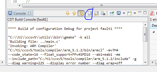

    Can you post your build log?

    Still get the following on building though:
    **** Build of configuration Debug for project qs-blox ****
    "C:\\ti\\ccsv5\\utils\\bin\\gmake" -k all
    'Building file: C:/StellarisWare/boards/rdk-idm-sbc/qs-blox/blox_fs.c'
    'Invoking: ARM Compiler'
    "C:/ti/ccsv5/tools/compiler/tms470_4.9.5/bin/cl470" -mv7M3 --code_state=16 --abi=eabi -me -O2 -g --include_path="C:/ti/ccsv5/tools/compiler/tms470_4.9.5/include" --include_path="C:/StellarisWare/boards/rdk-idm-sbc/qs-blox/ccs" --include_path="C:/StellarisWare/boards/rdk-idm-sbc" --include_path="C:/StellarisWare" --include_path="C:/StellarisWare/third_party/blox" --include_path="C:/StellarisWare/third_party/bget" --include_path="C:/StellarisWare/third_party/jpeg" --include_path="C:/StellarisWare/third_party/lwip-1.3.2/apps" --include_path="C:/StellarisWare/third_party/lwip-1.3.2/src/include" --include_path="C:/StellarisWare/third_party/lwip-1.3.2/src/include/ipv4" --include_path="C:/StellarisWare/third_party/lwip-1.3.2/ports/stellaris/include" --include_path="C:/StellarisWare/utils" --gcc --define=ccs="ccs" --define=PART_LM3S9B92 --define=INCLUDE_BGET_STATS --define=TARGET_IS_TEMPEST_RB1 --diag_warning=225 --display_error_number --gen_func_subsections=on --ual --preproc_with_compile --preproc_dependency="blox_fs.pp"  "C:/StellarisWare/boards/rdk-idm-sbc/qs-blox/blox_fs.c"
    "C:/StellarisWare/third_party/lwip-1.3.2/src/include/lwip/opt.h", line 45: fatal error #5: could not open source file "lwipopts.h"
    1 fatal error detected in the compilation of "C:/StellarisWare/boards/rdk-idm-sbc/qs-blox/blox_fs.c".
    Compilation terminated.
    gmake: *** [blox_fs.obj] Error 1
    >> Compilation failure
    'Building file: C:/StellarisWare/boards/rdk-idm-sbc/qs-blox/blox_web.c'
    "C:/ti/ccsv5/tools/compiler/tms470_4.9.5/bin/cl470" -mv7M3 --code_state=16 --abi=eabi -me -O2 -g --include_path="C:/ti/ccsv5/tools/compiler/tms470_4.9.5/include" --include_path="C:/StellarisWare/boards/rdk-idm-sbc/qs-blox/ccs" --include_path="C:/StellarisWare/boards/rdk-idm-sbc" --include_path="C:/StellarisWare" --include_path="C:/StellarisWare/third_party/blox" --include_path="C:/StellarisWare/third_party/bget" --include_path="C:/StellarisWare/third_party/jpeg" --include_path="C:/StellarisWare/third_party/lwip-1.3.2/apps" --include_path="C:/StellarisWare/third_party/lwip-1.3.2/src/include" --include_path="C:/StellarisWare/third_party/lwip-1.3.2/src/include/ipv4" --include_path="C:/StellarisWare/third_party/lwip-1.3.2/ports/stellaris/include" --include_path="C:/StellarisWare/utils" --gcc --define=ccs="ccs" --define=PART_LM3S9B92 --define=INCLUDE_BGET_STATS --define=TARGET_IS_TEMPEST_RB1 --diag_warning=225 --display_error_number --gen_func_subsections=on --ual --preproc_with_compile --preproc_dependency="blox_web.pp"  "C:/StellarisWare/boards/rdk-idm-sbc/qs-blox/blox_web.c"
    1 fatal error detected in the compilation of "C:/StellarisWare/boards/rdk-idm-sbc/qs-blox/blox_web.c".
    >> Compilation failure
    gmake: *** [blox_web.obj] Error 1
    'Building file: C:/StellarisWare/boards/rdk-idm-sbc/qs-blox/qs-blox.c'
    "C:/ti/ccsv5/tools/compiler/tms470_4.9.5/bin/cl470" -mv7M3 --code_state=16 --abi=eabi -me -O2 -g --include_path="C:/ti/ccsv5/tools/compiler/tms470_4.9.5/include" --include_path="C:/StellarisWare/boards/rdk-idm-sbc/qs-blox/ccs" --include_path="C:/StellarisWare/boards/rdk-idm-sbc" --include_path="C:/StellarisWare" --include_path="C:/StellarisWare/third_party/blox" --include_path="C:/StellarisWare/third_party/bget" --include_path="C:/StellarisWare/third_party/jpeg" --include_path="C:/StellarisWare/third_party/lwip-1.3.2/apps" --include_path="C:/StellarisWare/third_party/lwip-1.3.2/src/include" --include_path="C:/StellarisWare/third_party/lwip-1.3.2/src/include/ipv4" --include_path="C:/StellarisWare/third_party/lwip-1.3.2/ports/stellaris/include" --include_path="C:/StellarisWare/utils" --gcc --define=ccs="ccs" --define=PART_LM3S9B92 --define=INCLUDE_BGET_STATS --define=TARGET_IS_TEMPEST_RB1 --diag_warning=225 --display_error_number --gen_func_subsections=on --ual --preproc_with_compile --preproc_dependency="qs-blox.pp"  "C:/StellarisWare/boards/rdk-idm-sbc/qs-blox/qs-blox.c"
    >> Compilation failure
    1 fatal error detected in the compilation of "C:/StellarisWare/boards/rdk-idm-sbc/qs-blox/qs-blox.c".
    gmake: *** [qs-blox.obj] Error 1
    gmake: Target `all' not remade because of errors.
    **** Build Finished ****
    Kevin

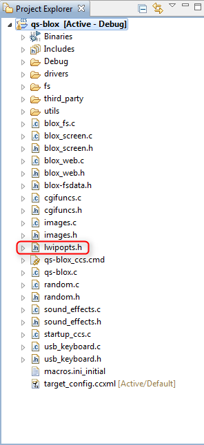

  • OK, it looks like your project is still located in the stellarisware folder. Perhaps your import went wrong. Usually when you import a project into your workspace it gets a new location. Specifically it is doing --include_path="C:/StellarisWare/boards/rdk-idm-sbc/qs-blox/ccs" This should be your project location in the workspace.
    I would try starting from a clean set. I can compile successfully.
    1. Extract the http://www.ti.com/tool/sw-rdk-idm-sbc file again to a new location.
    2. Create a new workspace (mine is "C:/ti/workspace_CCS5.5/qs-blox" "C:/ti/workspace_CCS5.5")
    3. Import the qs-blox project. When I do I can't select the "Copy project into workspace" option.
    4. Build the debug version.
    I've attached my build log so you can compare. Please note that I probably can't help much with the actual usb keyboard issue as I don't have this hardware (or any M3 parts).
    edit: correct workspace location
    I followed as similar procedure as stepman: downloaded the RDK-IDM-SBC, installed in a directory different than my original Stellarisware, imported the project. BTW, that is what I see when I import the project: special attention that the option Copy projects into workspace is mandatory):
    Just adding to stepman's suggestions:
    - Usually updating CCS - i.e., installing over a previous release - can cause trouble. It is always better to wipe out the existing install beforehand or install to a different directory and use a different workspace.
    - As stepman said, the file <lwipopts.h> is located in the project directory itself and should be physically copied to the workspace as shown in the Project Explorer below:

  • Thanks Stepman, I have created a completely new workspace and installed the RDK_IDM_SBC into a new location.
    The import now seems to be OK, into CCS v5.5 and I am able to build the debug version and this works with my USB keyboard on the RDK_IDM_SBC hardware.
    Rafael, the step-by-step instructions were very useful. Thanks.
