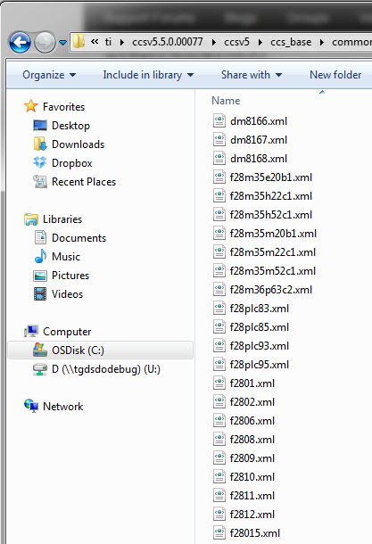

When I try to set up a Target Configuration, EZDSPF2812 does not show up in Board or Device list in CCS v5.3 . Note CCS v3.1 was installed first and then 5.3 was installed to use XDS2xx USD Emulator.

I do not have that file in the boards directory.
I installed C28xx components, so perhaps I missed this when I installed. Do I need to uninstall then reinstall with C2000 selected or is there a way to do that without reinstalling?
Under installed software I have C2000 Compiler v6.1 help, C2000 Emulation Flash and TI C2000 Device Support. Is there something else I should see in my list of Installed Software?
Thanks.
Looks like you have the C2000 components installed then. Not sure how you are missing the file for the ezdsp. Try creating a target configuration using 'TMS320F2812' for the device. The configuration should be nearly identical as the ezdsp option if you are using an XDS200
