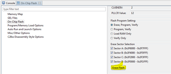

  • Jim,
    Right click on your project and select properties.  Go down to Debug.  From there you can access all of the debug settings.  This option is only available if you have a target configuration file in your project.
    That capture is for F2812.  If you do not have a target configuration in your project you can access the same options from within a debug session from the Tools menu.

  • The functionality varies by target.  The screen capture above is for an F28027 (should be there for any C2000) but you can see an action to erase the flash within the flash settings.  This is not there for MSP430 unfortunately.  I will check if we have an enhancement filed to add this for MSP and if not I will file one.
