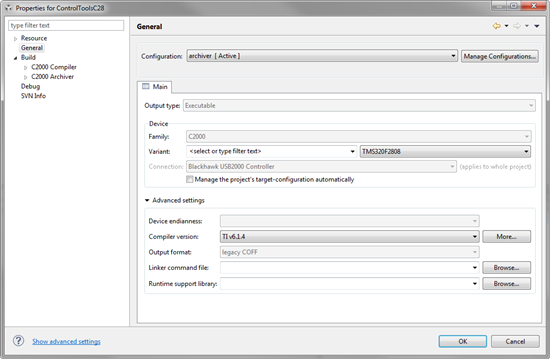

    With the informations of the wiki I was able to create a new configuration in same project (ram(equivalent to debug), release and a new "archiver" configuration).
    For debug and release I use a "Executable Output type" (Tool Chain Editor with TI Build Tools with used tools C2000 Compiler and C2000 Linker). The properties for my project looks like this picture:
    For the "archiver" configuration I have modified the Tool Chain with used tools C2000 Compiler and C2000 Archiver (instead C2000 Linker). I've made this change in C/C++ Build-->Tool Chain Editor. On this way, I could set in project itself the archiver properties, by changing my configuration. In this case the properties for my project looks like this picture:
    By excluding the source files I don't want add to *.lib, I could generate my own *.lib to share our useful functions in our group.
