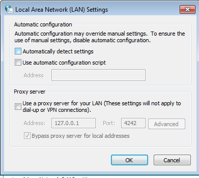

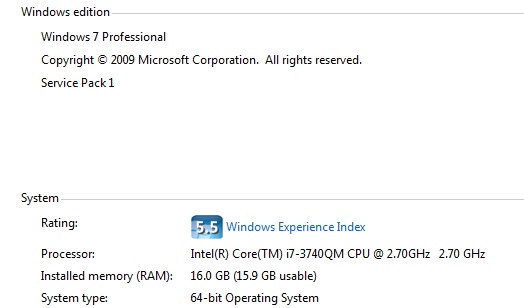

  • If it takes a long time to load, it could be your machine have a proxy setting that limits the traffic for GUI Composer. Can you try to disable your system's proxy setting and see if there is any differences for the loading performance?
    Can you also let us know your PC spec?

  • I did what you said and tried the mozilla browers and still no luck.  My computer is:
  • Hi Teresa,
    You have a fast PC, the PC shouldn't be the bottleneck. Since you were able to load GC after a long period of time, there must be some setting that is conflicting with GC. Did you try disabling your system proxy if there is any?

  • Hi Patrick
    Here is what my lan setting looks like and think it is disabled.
    The other test I did was I opened mozilla and tried to brower to the server by typing in http://127.0.00.1:4242 and it never connected.  What other test can I try see if the websever is even running

  • Hi Patrick,
    It is now working. My screenshot that I attached was deceiving because it shows the automatic detect unchecked which was the last thing I tried and I thought it did not help. But unchecking this made everything work. Does unchecking this disable the proxy?
  • I guess you didn't press the OK button. :) Yes unchecking the checkbox(s) means disabling.

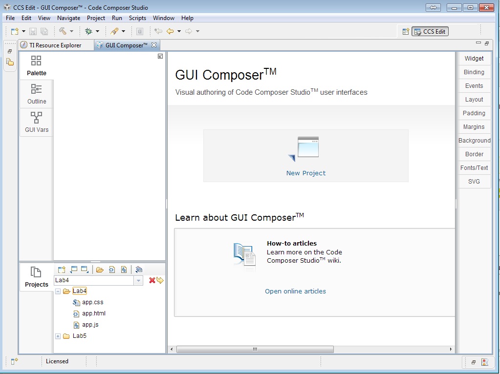

  • The project seems to be fine, I was able to open it in GUI Composer. Can you send a screen shot of GUI Composer? I like to see what is in your Project View. i.e how the files are layout. If you still stuck, try to delete the .GUIComposer folder in your workspace after shutting down CCS and start fresh.

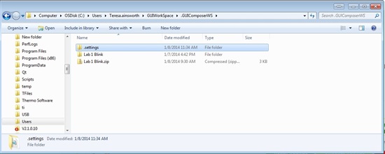

  • I don't think you understood my question I read through the step and I don't think GUI Composer will work for me. i will need to create my code using the TIVA graphics library

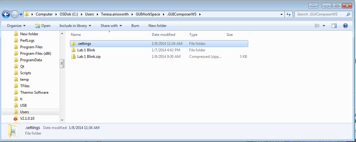

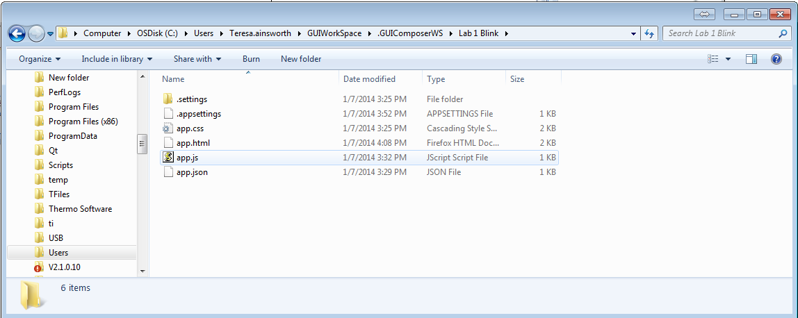

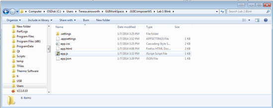

  • Regarding the loading issue, your project files are one level deeper than it should be. To be more precise, the .settings folder in your project needs to be at the root of the project folder. Can you double check if all the files, including the .setting folder, for this project are located under workspace/.GUIComposer/Lab 1 Blink/ ?
    I am not familiar with the TIVA graphic library. If you add a variable to the expression view within CCS and enable realtime update, do you see the value change while the target is running? GUI Composer works the same, it read/write variables using the same debug engine as CCS.
  • It looks like I have to .setting folders. Do I delete the one that is at the same level as Lab 1Blink? Why would this happen when I created the projects in GUI Composer inside CCS?
  • Assuming that the files are the same as the one you have attached in this thread. Keep the one that is inside the Lab 1 Blink.
    I don't know why it would create folder in such way, I haven't seen this before. Since you haven't done much to this project, can you reproduce this by deleting the entire .GUIComposerWS folder and restart from creating the project from scratch?

  • It seemed to work fine when I created a new WorkSpace and had only one project as soon as I made a second project. I started to get the loading problem again
  • I have figured out the pattern that causes the loading error to happen. 1. Open the gui composer tab 2. Don't touch the drop down box but expand the project from the project list. 3. Double click on app.html than the loading will come up but not go away.
  • If you see the project folders listed in the project view, in your case Lab4 and Lab5. Your workspace is already in a bad state. The question is, how did it get into this state. This is what I like to know; the sequence of steps to get Lab4 and Lab5 to show up in the Project view, instead of app.css, app.html and app.js for the current project (Lab4).
  • It comes up that way when you start GUI Composer. I think it might have to do with the state it was left in when you close down GC. Another bug I found is if you have 2 project and let say you are looking at Lab 4. When the Lab 4  Palette is display and you double click on it's app.html now that app.html will be the one that is always viewed. If you select Lab 5 it will still be showing Lab 4's palette. If you double click on Lab 5's app.html nothing happens it does not become visible. Maybe this is how it gets screwed up in the first place. You think - why would click on Lab 4's app.html because it is alreayd visible but it can be slow in coming up so you start clicking things to get something to start happening. It seems to me that GC has some bugs.
