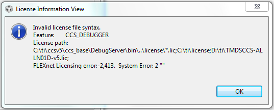

  • Hi Lisa
    It has been a while, but no I did not get CCS5  to accept a license file, even after recently  installing 5.5 new on a completely reformatted C: drive,  due to new operating system Installation. Below is the error message. In answer to your question, I am not sure that the license file ever worked now, because I may have just been using the free license.
    Will I be able to JTAG program and debug our own C2000 based board using a Spectrum Digital XDS100 Emulator using the free license option of CCS5? If so, then it is still not a problem to us.
    But still it is quite frustrating that it does not seem to accept what appears to be a valid license file. The MAC address is the correct one.
    Kind Regards
    Andrew
  • Hi Andrew,
    the xds100 emulator works on the free license.  If you are sure the license was generated for the eth0 address of the pc you are using CCS with, then I am not sure why the MAC address is being rejected.  We have not seen issues when the expected address is used.
    Lisa
