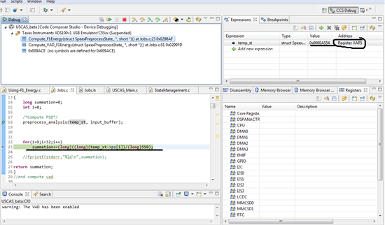

Primarily i have got this error on console while trying to look for a location
C55xx: Trouble Reading Memory Block at 0x483cea on Page 1 of Length 0x2: (Error -1143 @ 0x483CEA) Device core was hung. The debugger has forced the device to a ready state and recovered debug control, but your application's state is now corrupt. You should reset ....bla bla....
Processor : C5515 DSP
Emulator : xds100v1
CCS       : Version: 5.2.1.00018
OS         : Windows7
i am very sure that there were no problems been face with emulator or its configurations they are completely ok
This problem arise when i was calling a function the function executed well while returning back also its ok just after the function is executed the the value in the variable changed ! more improtantly its pointing  to a location they are not supposed to change ,more over its call by reference not even any temporary variables created in call
as the pointer has dangled the values changed, is that problem of my memory space allocated ?
which memory space limitation results in this type of pointer dangling ?

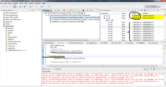

intresting the pointer retained its value when it returned from the function where it is present
here below shows the screenshots  of the debug state before and after the function call
before return from function that is actual values
after returning from the function call :

    to explain the problem more briefly when going in to that particular function the 'st' address is  0x0000a134
    respective figure:
    while exiting it that should not change but it has changed to --0x0000a554
    respective figure
    by observing the above screenshots its evident that the controller failed to transfer same pointer values in to called parameters so eventually the de-referencing is done to some other place creating a havoc
    finally as a last try i tried to comment that function call which avoid the dangling,from this its clear that the function calls further making these problems i think ,must be problem with stack or some other thing
    so from this i understood that the stack holds the return addresses,so i have improved the stack size to 64K then also the problem is not solved then i tried to increase it further then the linker throws me an error saying stack and sysstack should lie in a same 64K page !!!

    with this effect the map file has changed to 4213.map.txt
    still i am having this same error !
    [/quote]
  • desouza said:
    waiting from long time for your reply, mean while i tried to debug my problem a lot,why is it tries to read what ever it wants from !
    to check this further i have used some printf to print what its actually fetching,its fetching some other buffer other than what its supposed to
    is that any problem of any alignment issues please have a look
