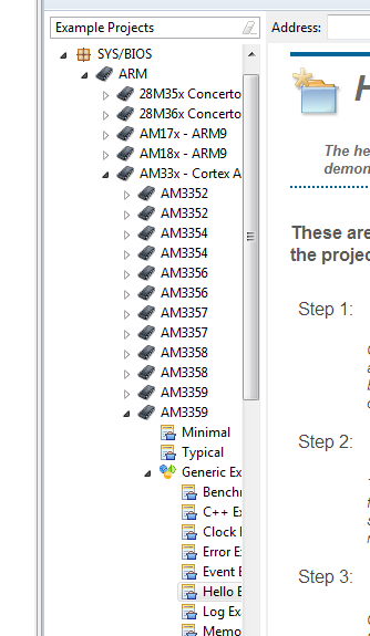

Ti Resource Explorer, AM3359, Generic Example, Hello Example, configured as Cortex M3
Other Parts Discussed in Thread: AM3359
Start from installer, TI Resource Explorer, AM3359, Generic Example, Hello Example,
result configured as Cortex M3
with clean install of 5.5.0.00077
    Do you mean SYS/BIOS examples?
    If so under SYS/BIOS -> ARM -> AM33x Cortex A8 there are two sub-sets of AM3359 examples in CCS 5.5.0.00077:
    The first AM3359 set, under TI target examples -> Generic examples are for the A8 core of the AM3359.
    The second AM3359 set, under Generic examples are for the Cortex M3 core of the AM3359.
    I think the confusion would be avoided if the SYS/BIOS -> ARM ->  AM33x Cortex folders in the TI Resource Explorer were labled as which are for the Cortex A8 .vs. Cortex M3 cores.
  • Thanks for the reply.
    In my case, I was looking for AM3359, skimmed to the end of the list, and selected it, assuming "AM3359" and "AM3359" were the same.
    I was under the (mistaken?) impression that the M3 on the AM335x ran masked-ROM firmware and is for all practical purposes not available for end-user programming. If so, M3 examples should perhaps not exist in the Example Projects -- this would be an advanced user/TI internal process. Does SYS/BIOS run on the AM3359's M3?

  • Dave Page said:
    SPRUH73J 8.1.4.6 is the relevant TRM reference?
    Yes
    Dave Page said:
    So, when running Industrial SDK on SYS/BIOS the M3 has no firmware loaded and merely stays in reset.
    The reset value of the WKUP_M3_LRST field in the RM_WKUP_RSTCTRL Register is documented as a value of 0x1 = ASSERT : Reset is asserted for the M3 by A8.
    So yes, that means at at AM335x reset the M3 will be held in reset and will remain inactive unless the A8 releases the M3 from reset.
  • Dave Page said:
    As you suggested, I agree I would be less confused if the AM335x example project folders called M3 explicitly.
    This has been done in CCSv6 beta 3:
