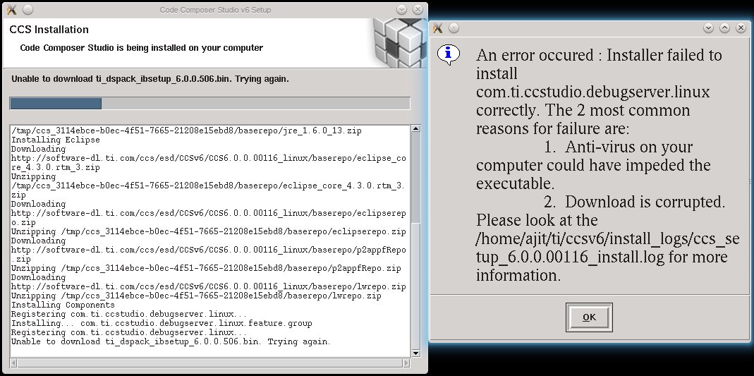

CCSv6 Beta3 64bit gentoo install problem
I tried several times installing CCSv6 Beta3 on my gentoo 64bit laptop as a normal user. Every time it failed for the same reason
I have attached the log files and the screen capture with the error message

01/25/2014 20:50:33pm - runEclipseApp - #
# An unexpected error has been detected by Java Runtime Environment:
#  SIGSEGV (0xb) at pc=0xf76c1e05, pid=24639, tid=4149553984
# Java VM: Java HotSpot(TM) Server VM (11.3-b02 mixed mode linux-x86)
# Problematic frame:
# C  [libc.so.6+0x128e05]
# An error report file with more information is saved as:
# /tmp/ccs_7a1c8262-3af2-4339-420c-e953b38b754f/eclipse/hs_err_pid24639.log
# If you would like to submit a bug report, please visit:
#   http://java.sun.com/webapps/bugreport/crash.jsp
child killed: SIGABRT
01/25/2014 20:50:43pm - runEclipseApp - Running again
01/25/2014 20:50:43pm - runEclipseApp - can't run for a fourth time
01/25/2014 20:50:43pm - runEclipseApp - #
#  SIGSEGV (0xb) at pc=0xf7684e05, pid=24711, tid=4149304128
# /tmp/ccs_7a1c8262-3af2-4339-420c-e953b38b754f/eclipse/hs_err_pid24711.log
child killed: SIGABRT failed.
01/25/2014 20:50:43pm - installEclipse - Eclipse installation failed have to exit here
01/25/2014 20:50:43pm - installEclipse - CCS_ERROR: Failed to install eclipse. Cannot recover from this error.

01/25/2014 20:51:46pm - processOtherFeatures - ti_dspack_ibsetup_6.0.0.506.bin does not exist at /home/ajit/ti/ccsv6/eclipse/downloads/ti_dspack_ibsetup_6.0.0.506.bin. Setting state to feature downloaded
01/25/2014 20:51:46pm - checkStatus - CCS_ERROR: Installer failed to install com.ti.ccstudio.debugserver.linux correctly. The 2 most common reasons for failure are:
	1.  Anti-virus on your computer could have impeded the executable.
	2.  Download is corrupted.
Please look at the /home/ajit/ti/ccsv6/install_logs/ccs_setup_6.0.0.00116_install.log for more information.
01/25/2014 20:51:46pm - checkStatus - saving /home/ajit/ti/ccsv6/install_logs
01/25/2014 20:51:46pm - checkStatus - CCS_ERROR: Code Composer Studio v6 installation failed.

The log file indicates JVM segment violations. Is it possible to use pre-installed java in this case? Any suggestions how I can fix this?
I have also saved the hs_err_pid24639.log and hs_err_pid24711.log on my machine. Please let me know in case its going to help in any way
-Ajit
  • Have you run the dependency checker on your Linux system (check here), and did it find anything missing?
  • I ran the dependency checker and here is the output:
    ajit@rog /tmp $ ./check_depends.sh
    Installed versions of glibc and glibcxx: GLIBC_2.18, N/A
    Required versions of glibc and glibcxx: GLIBC_2.7, GLIBCXX_3.4.16
    Checking availability of libraries in ext-depends.txt ...
    Done.
    I also tried running the generate depencies script (generate_depends.sh). This is mostly useless in this case because the install fails before copying most of the linux binaries in the installation folder
    Any other ideas?
  • The current version of glibc (glibc-2.18-r1) and 32 bit programs with unaligned memory access do not go well together. I have used a work around for now so the 32 bit JVM works without crashing on my 64 bit gentoo laptop http://forums.gentoo.org/viewtopic-p-7489702.html?sid=ab79255e693aba339de91514fa001b1e
    Next problem I am facing is when the installer tries to download this file (url copied below). I tried downloading this using alternative methods but there was no success. Not even a single byte gets downloaded
    http://software-dl.ti.com/ccs/esd/CCSv6/CCS6.0.0.00116_linux/baserepo/utils.zip
    Is there some issue with the download server? Can someone please look into this?
  • Above utils.zip file download problem is now resolved and I am able to install CCSv6 on my gentoo laptop. I haven't yet tried using it though
