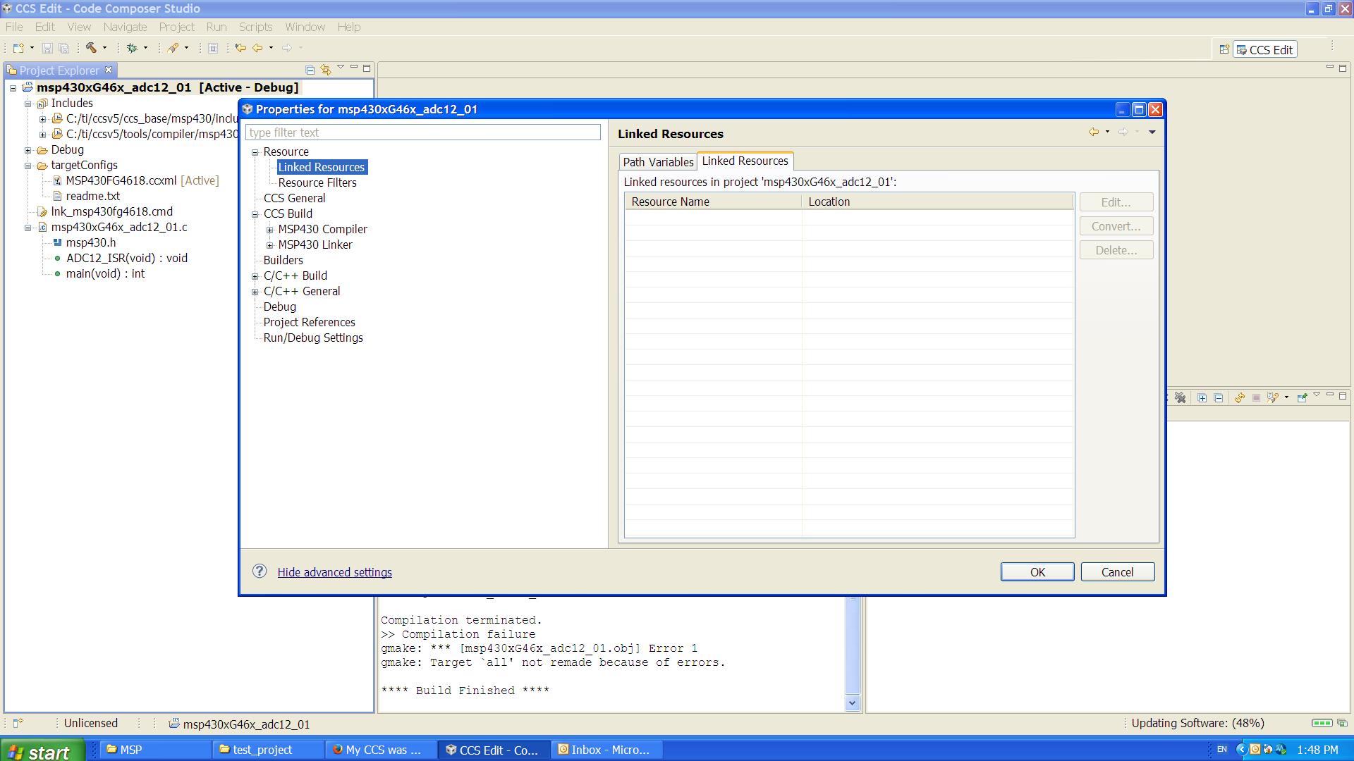

  • In my view linked resource is empty.
    How to edit it as it is masked?
    Path variable looks good.
  • Hi  Lisa
    Please see the screen short resource link is empty.
    Is there a way to edit it.May be this is issue.
    Re-installing is last option as it takes lot of time due to those java issues.
  • Hi Rakesh,
    Do you have any linked files?   That window shows any linked files in the project.  Have a look at the wiki.   It shows you where to include non linked paths for added not linked files.   THis is in the compilers include options.

  • yes i am building a built in example .I am not sure what caused this but looks like i need to uninstall now both version 4 and 5 then re install just 5.
