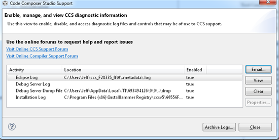

CCS v5.5.0 cannot connect XDS100v1 on Experimenter Kit F28335
Other Parts Discussed in Thread: AM3358, TMS320VC5505
I have a PC installed CCS v5.5.0 on Windows 7, 64 bits. It cannot pass connection test with Experimenter Kit F28335. It always stops at the same test pattern, see below please. I have tried to change (lower) the clock frequency of XDS100 v1 settings several times. It doesn't work. This PC is about 2 and half years old, AMD CPU.
On the contrary, another DELL new i7 PC (Windows 8, 64 bit) can pass the test, but I would use the old AMD PC for the F28335 project.
Anyone can help diagnose the problem? Thanks a lot.

  • I make it clear to previous post. The test is always not finished. The test should be finished with a succeed line.
    When I use it in debug, it also has connection problems now and then.
  • Hi Robert,
    Please check your device manager. Are the XDS100 drivers installed properly?
    Gautam
    The AMD PC previously was used to connect AM3358 Starter Kit, which has XDS100v2. It still work well with AM3358 SK.
    I can see the USB serial port added when I connect F28335 Experimenter Kit. I don't know why it does not finish the test yet. Any other way to check device manager?
  • The phenomenon is that the test stuck at the last test line. When I turn off the Experimenter Kit, the test message will finish, see below please. But the normal debug still does not work yet.

  • Excuse me. I forgot to say that the JTAG CLK frequency is 100KHz in last post.
    For default JTAG CLk (1 MHz), it still does not finish even after turn off the kit.
  • Robert, F28335 Experimenter's kit has a XDS100v2 and not XDS100v1. Can you once check by modifying your target configuration to XDS100v2?
    Gautam
    I have tried XDS100v2. The problem is still there for the default JTAG CLK configuration. Or JTAG CLK is set to fixed CLK frequency (100K, 500K, 1MHz) Test connection only shows:

    Yes, please. Robert, please reproduce the issue while generating a debug server log. Zip it up and attach it to this thread.
    http://processors.wiki.ti.com/index.php/Troubleshooting_CCSv5#Debug_Server_Logging
    ki
    I enable the debug server logging dump as in your link. This is the screen shot of that settings:

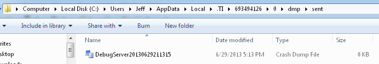

    I go back to "Coder Composer Studio Support", highlight "Debug Server Dump File" bar, then click View. The folder shows the old dump file.
    What am I wrong?
  • Debug server logging applies to a debug session. It won't record anything from the "Test Connection" button. Start a debug session and try to connect to the target.
    Also, I don't see a path specified for log. You may want to specify one.
  • 3463.debugdmb.zip
    Here is the log file. The debug can run, but it cannot finish. It stuck there when halt debug process.
