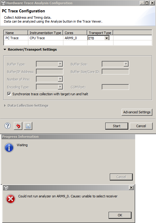

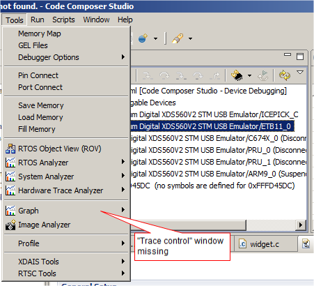

1. “Trace Control” window is missing (screenshot 1).
2. When running “Hardware Trace Analyzer”, either “Code Coverage” or “Function Profiling” or “PC Trace” fail to start showing error prompt “Could not run analyzer on ARM9_0. Cause: unable to select receiver” (screenshot 2).
screenshot 1
screenshot 1

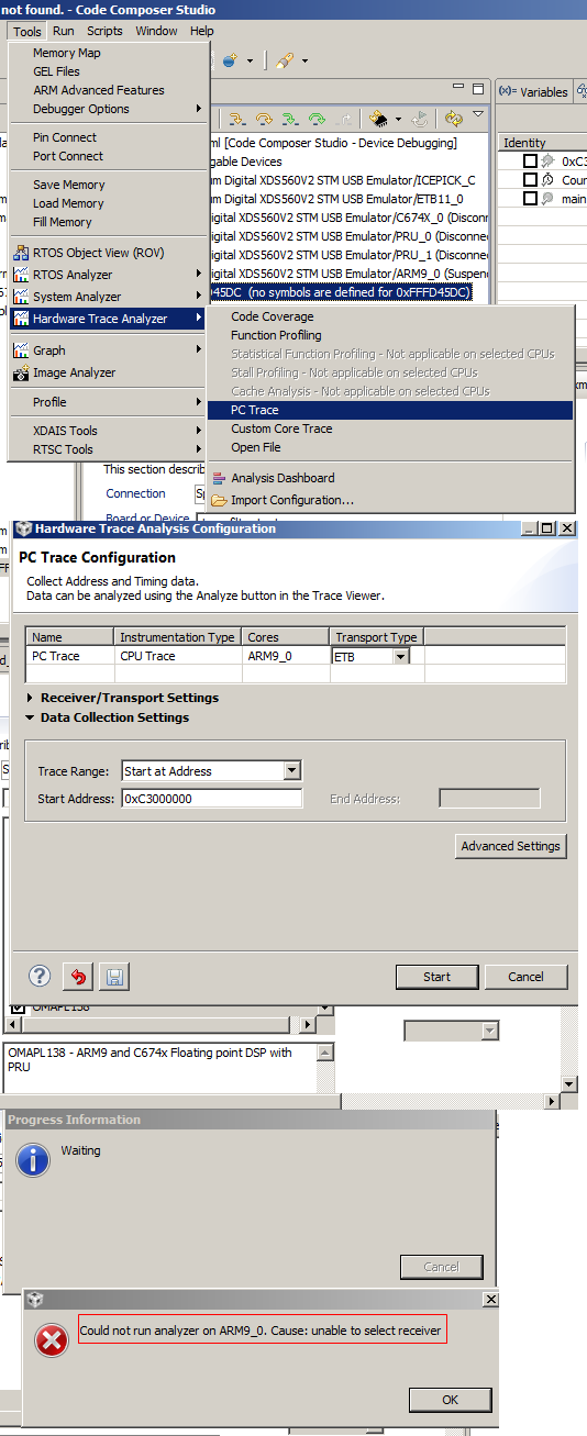

    ARM9 trace was removed by accident at a certain point in the evolution of emulation packages, but it is back in the latest couple releases - please check the screenshot below in my setup with release 5.1.340.0:
    The latest release is 5.1.402.0 and is available in the Code Composer Studio Update tool or at this page.

    Screenshot this time (the same as before XDS 5.1.402.0 updating):
    Paul

    I am unsure what may be happening in your case, since I just updated my copy of CCS to 5.1 402.0 and just confirmed it working for me as well.
    Usually when strange behavior happens to me, I tend to perform the steps in the sections General IDE and Debugger of the troubleshooting page. This tends to fix things for me, especially if the trace cache files are corrupt.
