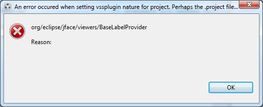

I tried to follow the help from the wiki for installing the VSS-plugin. Unfortunately this was not succesfull since the integration did not start at all. I found out that there is a missing dependency to the JDT project. After installing JDT the VSS Plugin crashes with the following exception: java.lang.NoClassDefFoundError: org/eclipse/jface/viewers/BaseLabelProvider.
What is the problem?
I'm using Code Composer Version: 4.0.1.01001
Yours sincerely,
Patrik Lehmann
  • Patrik,
    When do you see the error?  I have updated the instructions to include a step for installing JDT (for Eclipse 3.2).
    I have installed the plug-in.  When I first tried to customize the perspective I got a decorator error (no details) but I tried again and it let me add the VSS menus to the perspective.  I was also able to open the VSS browser from the Window -> Show View -> Other menu.  Expand VSS to see the list of relevent views.  I could own the browser, checked out files and log views.  However I don't have VSS installed to actually test out the integration, thus my VSS menu items are disabled.  Do you get the errors when you click on one of the VSS menu items?
    John
  • Hello John,
    I get an error while opening a project and after trying to "share the project" with VSS.
    I'm currently using the following features and plug-ins:

    Thank you in advance.
    Regrads,
    Patrik
  • Patrik,
    We used to have a VSS license in the office.  I will see if I can find it tomorrow.
    John
  • Patrick,
    I found an old MSDN disk with VSS 6.0d on it.
    Is the attached error what you see:
    I found a reference to this somewhere else that suggests trying an older version of the plug-in (1.6.1 instead of 1.6.2) I will give that a try next.
    John
  • Good news!!!!!!!
    Using v1.6.1 of the plug-in fixes it.  I was able to create a new project in CCS, share it (run through the VSS config wizard), add it to version control, check out a file,use the checked out files view...
    I updated the page to have the link to the correct 1.6.1 package (there are 2, one works one doesn't).
    http://tiexpressdsp.com/index.php/SourceSafe_plugin_installation
    It is pretty neat.  It shows you the database path in the project view, as well as indicators that show that something is under source control and if it is checked out...
    John
  • Thank you John, the other version works for me.
    Patrik
