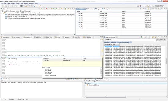

There appears to be a bug in either the IDE or the compiler. I'll let you decide which.
I've cut this function down to the bare bones, the problem occurs when I try to view the contents of parameters sent to a function, when there are more than 4 parameters that are not 32 bit values. In the example below I have 8 x 8bit parameters. When I try to view var5 to var8 they read zero, but var1 to var4 come out correctly.

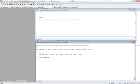

The code looks like this...
Doesn't get a lot more trivial than that. Here's what happens when I view it using CCS...
Now if you add up the value of all the parameters it comes to 36 (0x24). The memory browser on the right show the stack. The first 4 parameters are packed into a 32 bit space, then comes the return value in 16 bit space, then padding for 16 bits (I guess), the next 4 parameter each take up 32 bits. The IDE seems to be picking up the wrong space.
Why the last 4 8-bit parameter are packed into the stack frame in a different way to the first ones is a mystery, but the result comes out correctly. It does, however, make it difficult to debug. Sending 8 x 32 bit values works fine.
Andy

    I have some additional information that might be useful.
    If you look at my first post, at the last screen shot, you'll see var5 is packed into a 32bit space in the third word (of the memory window). Notice that it's packed into the Least Significant Byte, then look at the variable window above. The address shown for var5 is the Most Significant Byte. This could explain why it comes out as zero.
    Andy

  • Would you mind moving the thread over to the CCS forum, please?
    I wrote this noddy little test function to demonstrate the problem I was seeing in the real code. It took me no more than a couple of minutes to write. Recreating the problem shouldn't be difficult. I can't send the real code for reasons of commercial sensitivity.
    CCS V5.4.0.00091
    compiler is in a directory called arm_5.0.4 , I presume this is the version number.
    Micro TMS570LS3137

  • Hi Andy,
    Please tell me what you see in the variable view and what the PC is when you see 0 in var5.
    While it may appear that the first four parameters are assigned to R0-R3, they are copied to the stack at the beginning of the function.
    So, the locations of the first four parameters changes after the function prolog.
    In extreme cases, the location of a variable changes a few times during the execution of a function.
    Sometimes, the location of the variables may be undefined.
    The debugger interprets debug info generated by the compiler.
    The compiler may not be able to generate correct debug info in function prolog and epilog.
    Thus, viewing the local variables and parameters in function prolog and epilog may be incorrect.
    Raymond
  • Hi Raymond,
    The PC, at the point where the image below was taken, was 0x00003644 and SP 0x08000fd0.
    The data values being sent were as before: 0x0A, 0x02, 0x03, 0x04, 0x05, 0x06, 0x07 and 0x08 for vars1-8 respectively. The result for var8 looks interesting.

  • Hi Raymond,
    it doesn't make a difference. I've changed my test function to split it into several lines, like so:
    U16 TestFunc( U8 var1, U8 var2, U8 var3, U8 var4, U8 var5, U8 var6, U8 var7, U8 var8 )
        U16 Response;
        Response = var1 + var2;
        Response += var3 + var4 ;
        Response -= (var5 + var6) ;
        Response += var7 + var8;
        return Response;
    If I single step through the last line of the function, var5 - var8 all show a value of 0.
    Andy
