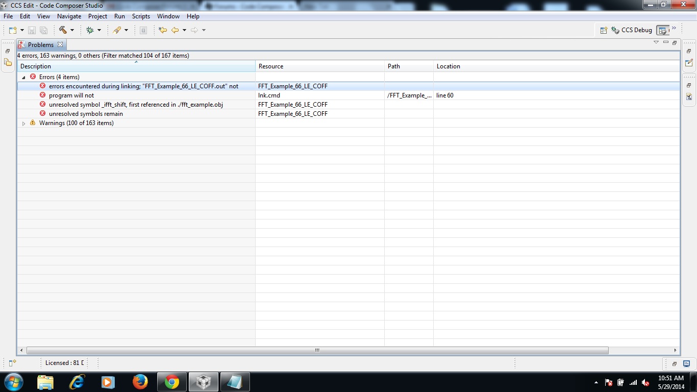

How to use DSP libraries in code composer studio v5 for an application on TMS320c6678 dsp processor.

Hi Gopal,
I hope you've included the required header files and linked them properly. Such errors are due to improper linking of header files.
Gautam
Hi Gautam,
I have included but i'm not knowing how to link it. Could you please explain.
thanks & regards,
Gopal
I would like you to refer this doc to get in detail explanation wrt to new projects:
6305.Keystone Workshop Lab Manual.docx
Gautam
Hi Gautam,
The problem fixed. Previously i kept ELF output format instead of Legacy Coff.
