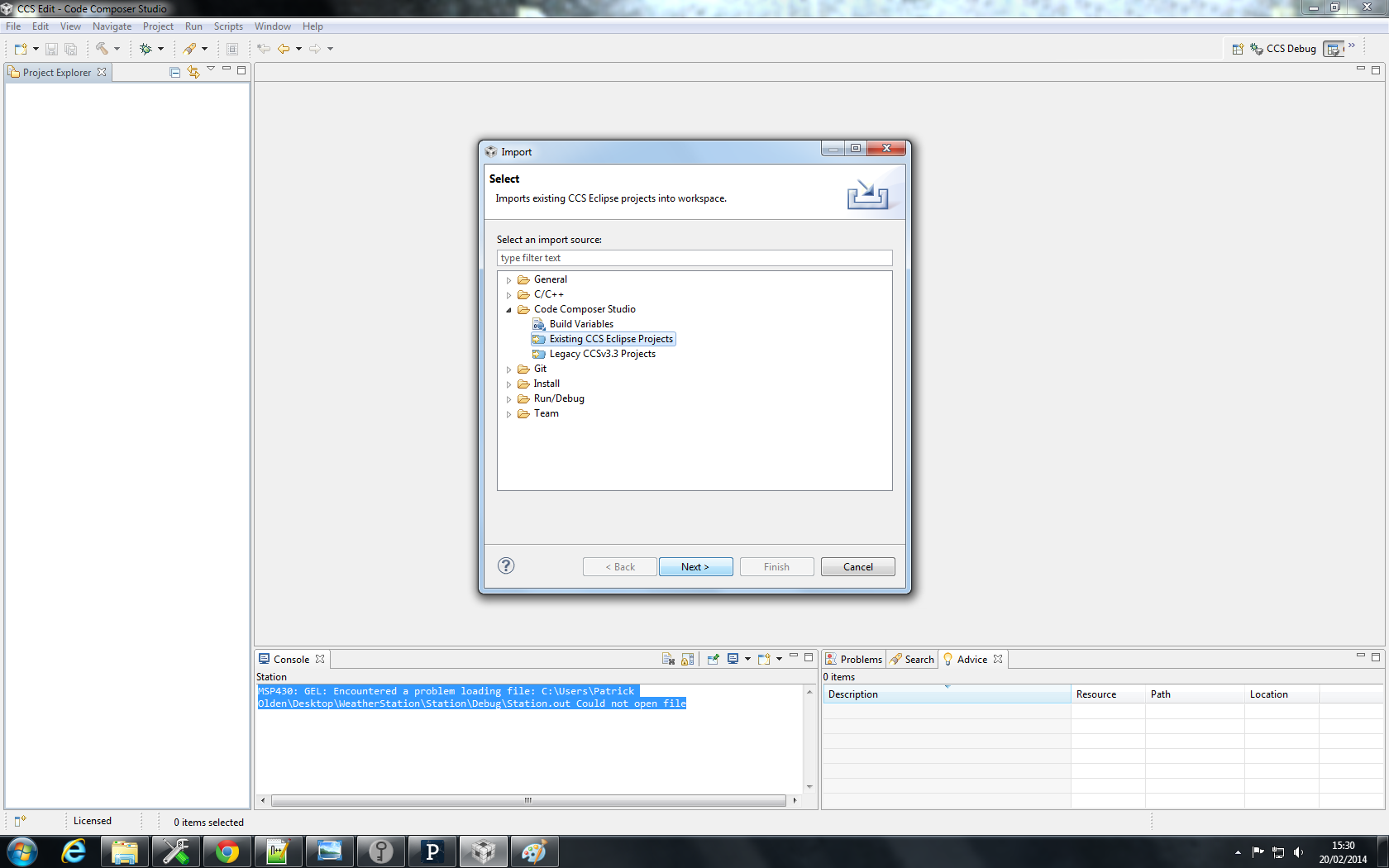

Hey I am extremely new to CCS and want to get a simple project running on my MSP430. I downloaded the project files from Jeremy Blums website, where he designs a simple weather station using the MSP430, the problem is when import the project files into my CCS it gives me an error saying that the .out files are missing.
 http://www.jeremyblum.com/2011/05/14/msp430-wireless-weather-station/comment-page-1/#comment-666078

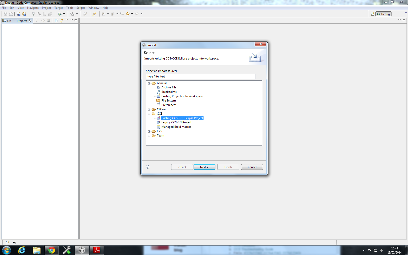

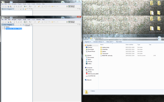

As I am a complete noob here are the screen shots of what I am doing just incase I am messing up while importing the project:
What I am doing to get to the below pic is: File > import > Existing CSS/CCE Eclipse Project

  • HI Patrick,
    I just imported the project fine in ccsv5.5.  I did project=>import existing ccs/eclipse project.
    I got no errors and only one warning on build.
    COuld you try that?
    Lisa

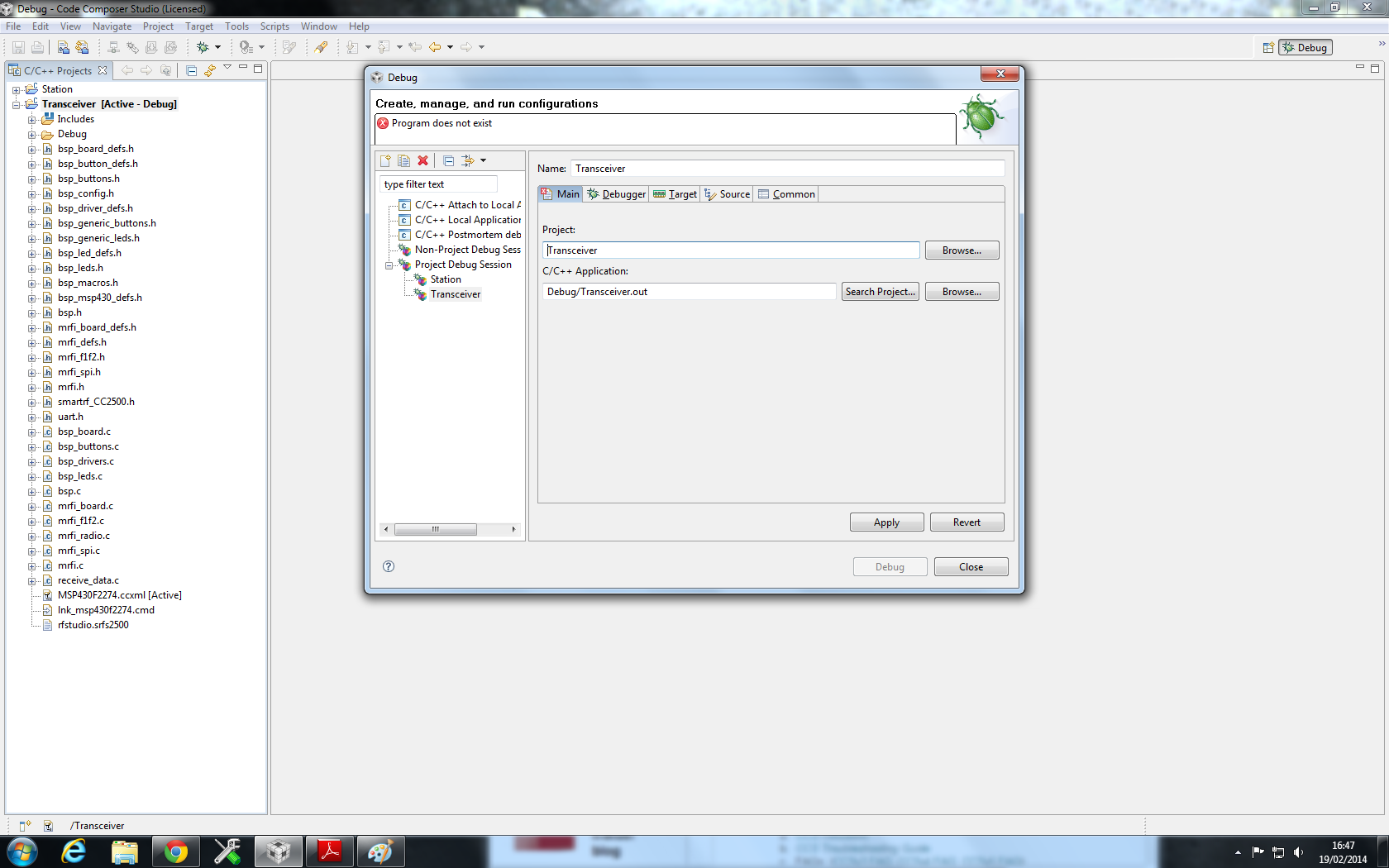

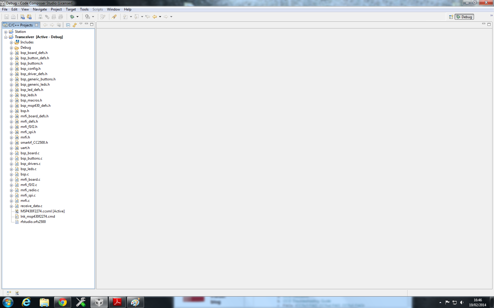

  • Am I doing something wrong when I import it, like when I import it I go:
    Clean > Then Debug Active Project
    and am I missing something when I import the project cos even when I view the folder that the projects are in there are no ,out files, like am I missing something that is required to generate them ?
    Thanks again for the help
  • Hi Patrick,
    what exact steps do you take.  Like I said, I can not reproduce this here.  Also, why are you doing a clean and then debug?  You should simply press the debug button (the one like a bug).
    Lisa

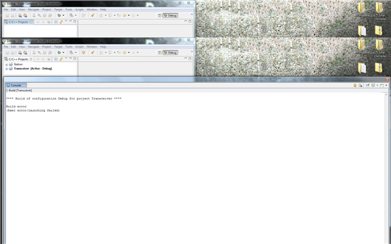

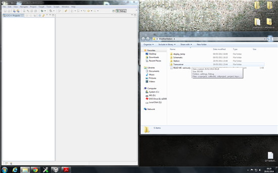

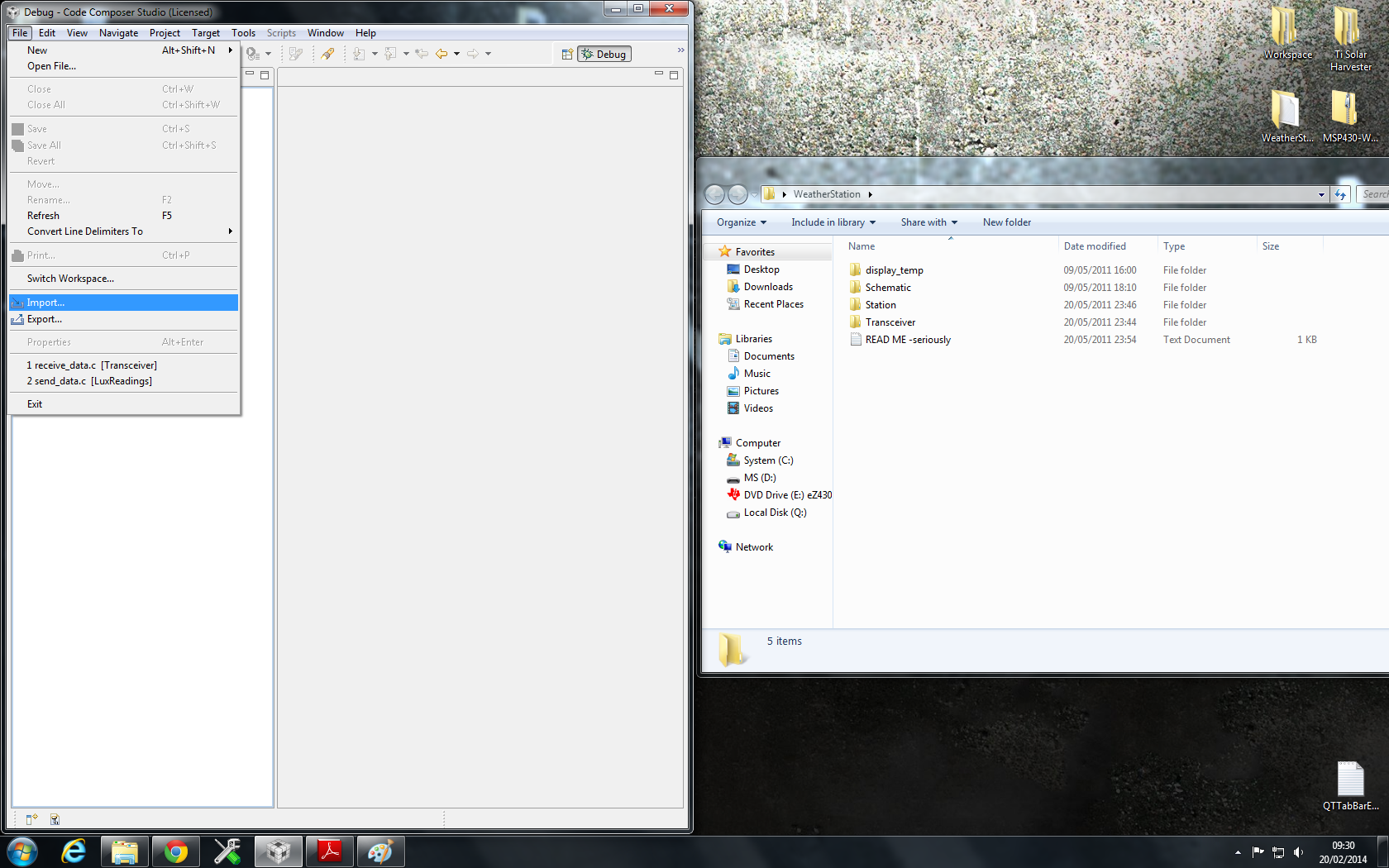

  • Hey Lisa, I came into college this morning and tried what you said and I'm still getting a "file missing" error, here are the exact steps that I took after I extracted the files from the zip and saved them on my desktop in a folder called "weatherstation"
    Here is a pic of the files in the folder I made:

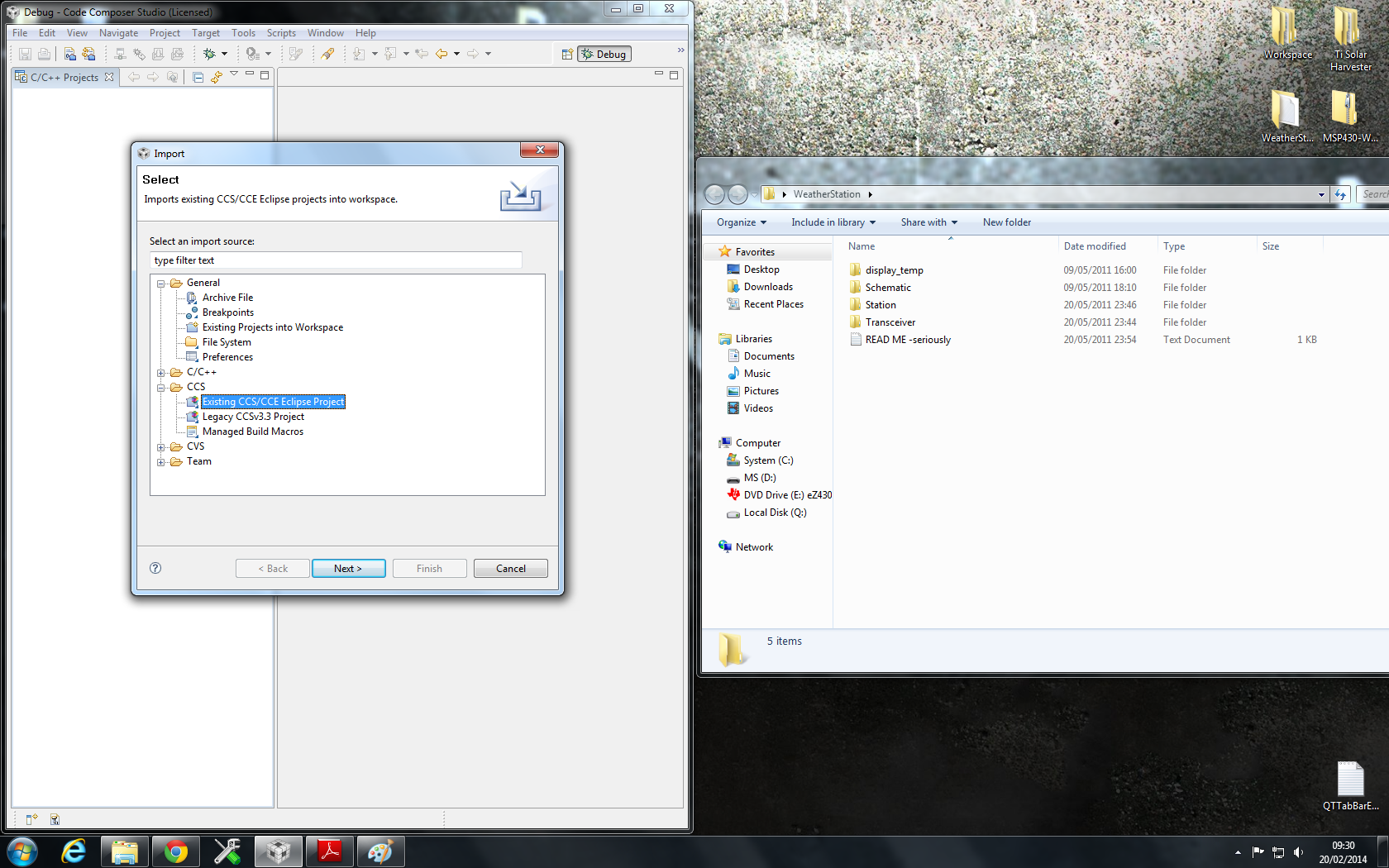

    I then went File > Import
    I then clicked existing css/cce eclipse project
    from here I clicked "from root directory" and then highlighted the "weather station folder", so it showed the station and the transceiver files in the window

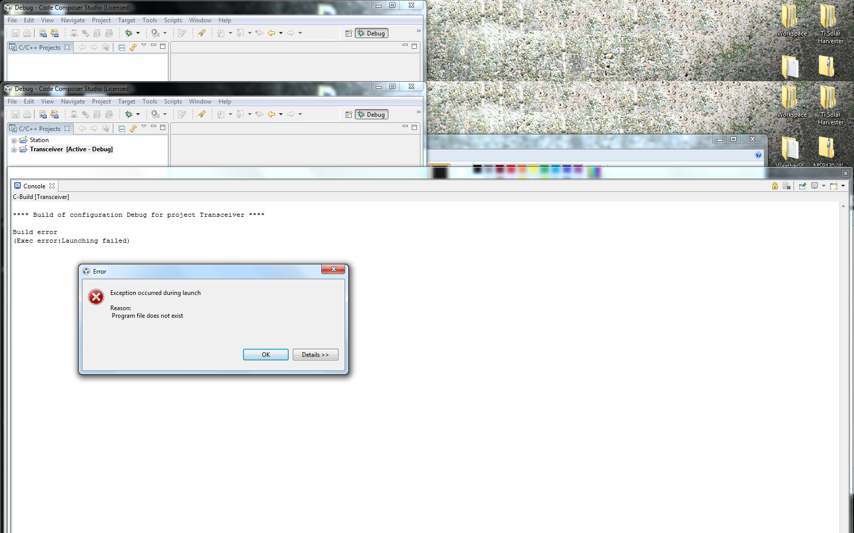

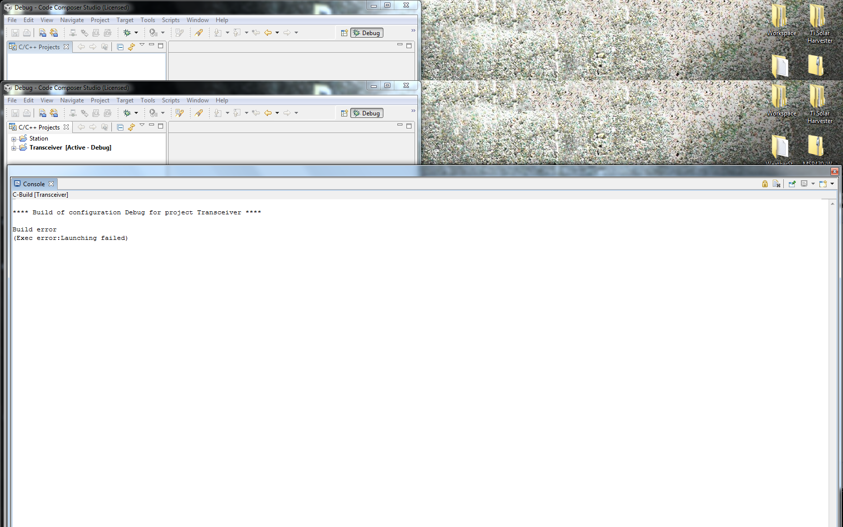

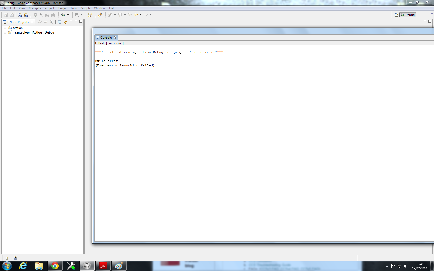

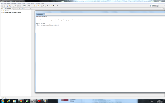

    I then clicked finish and then I got this error:
    I just closed this error and then clicked the debug button on the toolbar like so:
    Then I got the same error that I have been getting before.

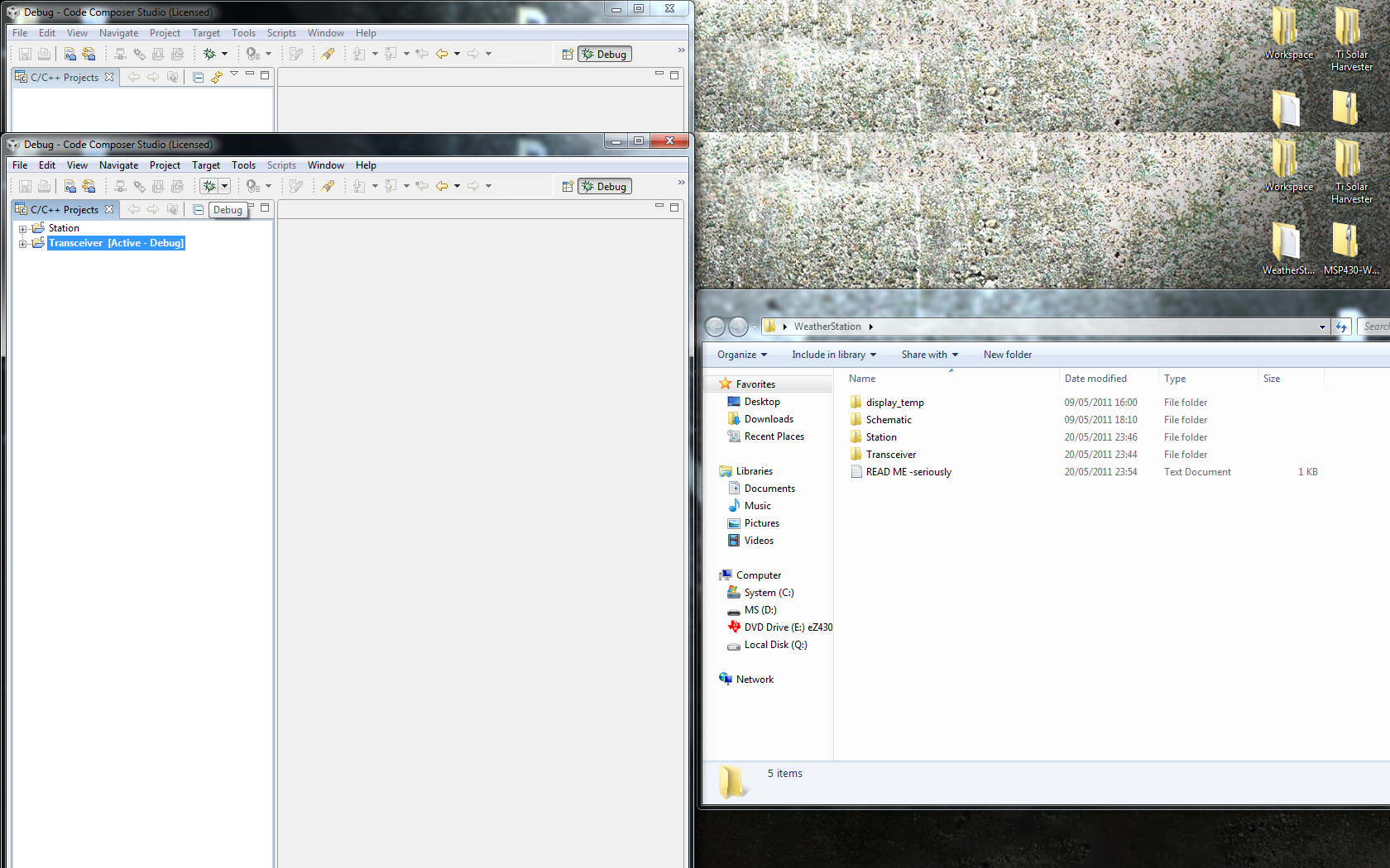

  • Just incase it was the software version that I was using I downloaded CCS v5.5 and used the free license that works with the MSP430 range, I got there same error when I tried to debug the project files.
    The screen caps below show what I did with the folder:
    Thanks again for the help,
    Patrick
  • Hi Patrick,
    how are you entering debug?  Also, is there .out file physically there or is it not being generated.  Either way, one possibility is a permissions issue in the directory not allowing ccs to read/write the file ... or antivirus.
    Lisa
  • No there is no .out file in the zip folder so I thought it might have been missing but the fact that you are able to download the zip and debug the files must mean that you are generating the .out files when you debug it. And to enter the debug, I am simply clicking the bug symbol on the top left.
