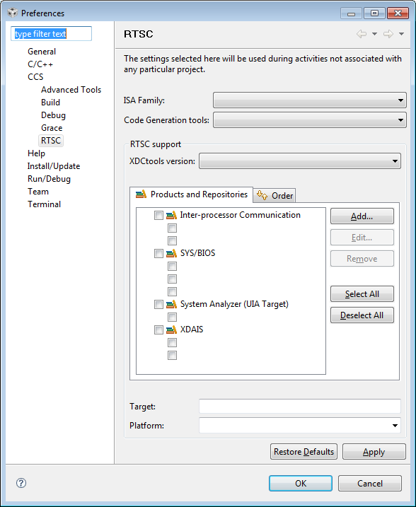

Brand new PC. Installed CCSv4 in c:\ti and then installed CCSv5 in c:\ti
When I go to CCSv4 -> window -> preferences -> CCS -> RTSC -> Products, I get an error saying
"The currently display page contains invalid values"
or
"An error has occurred. See error log for more details"
After clicking on the OK button a thousand times, the screen shows up below
Note that it cannot detect any RTSC. However when I ran CCSv4 the first time, it said it had detected several components and that are present in the c:\ti directory.
If I click on  CCS\Build, it shows me the CGT tools I have. It seems to be working for CGT.
In View -> Other -> PDE Runtime -> Error Log, I get the errors below
My other work colleague also has the same issue.
I wonder if this is because CCSv5 installed a JRE that is incompatible with CCSv4?

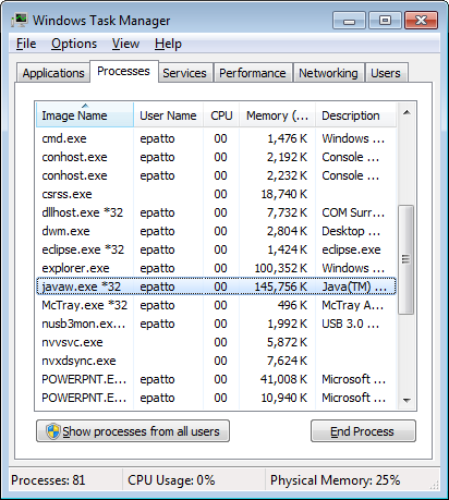

    I found the javaw.exe process (not the java.exe) in the win 7 task manager below and right clicked. Its running out of  C:\ti\ccsv4\eclipse\jre\bin. Since its running out of the ccsv4 directory, I should be running the right java version.
    In C:\ti\ccsv4\eclipse\jre\bin, I ran javaw -version and nothing happened. But running javacpl.exe in the same directory gave me "Version 1.5.0 (build 1.5.0_14-b03)".

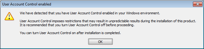

    I wonder if the issue I'm running into has to do with this warning when I start the installation. I'm selecting "run as administrator" when I start the install.
  • Attached  installjammer registry1682.DE4D64E9-C41B-458B-B599-E02DB4EFFFC6.log

    I changed User Access Control (UAC) to "Never Notify", rebooted, and re-installed into c:\ti. It works! Yay!
  • Turns out I also did something else besides disabling UAC. I also unchecked all the components it discovered in the c:\ti directory when it first booted up. It may be that CCSv4 doesn't like the CCSv5 RTSC components.
    Strange.
  • Hi Eddie,
    As you discovered CCS ships its own version of JRE, which it uses. It does not depend on system JRE nor other CCS versions JRE.
    One possibility may have been with write permissions. When RTSC products are discovered, they get registered with CCS. This process needs write permissions to installation directory to be able to make that "registration". CCSv4.x is based on a relatively old version of eclipse when user account permissions on windows was not use much.  CCS v5.x is a little bit better as it is using newer version of Eclipse.
