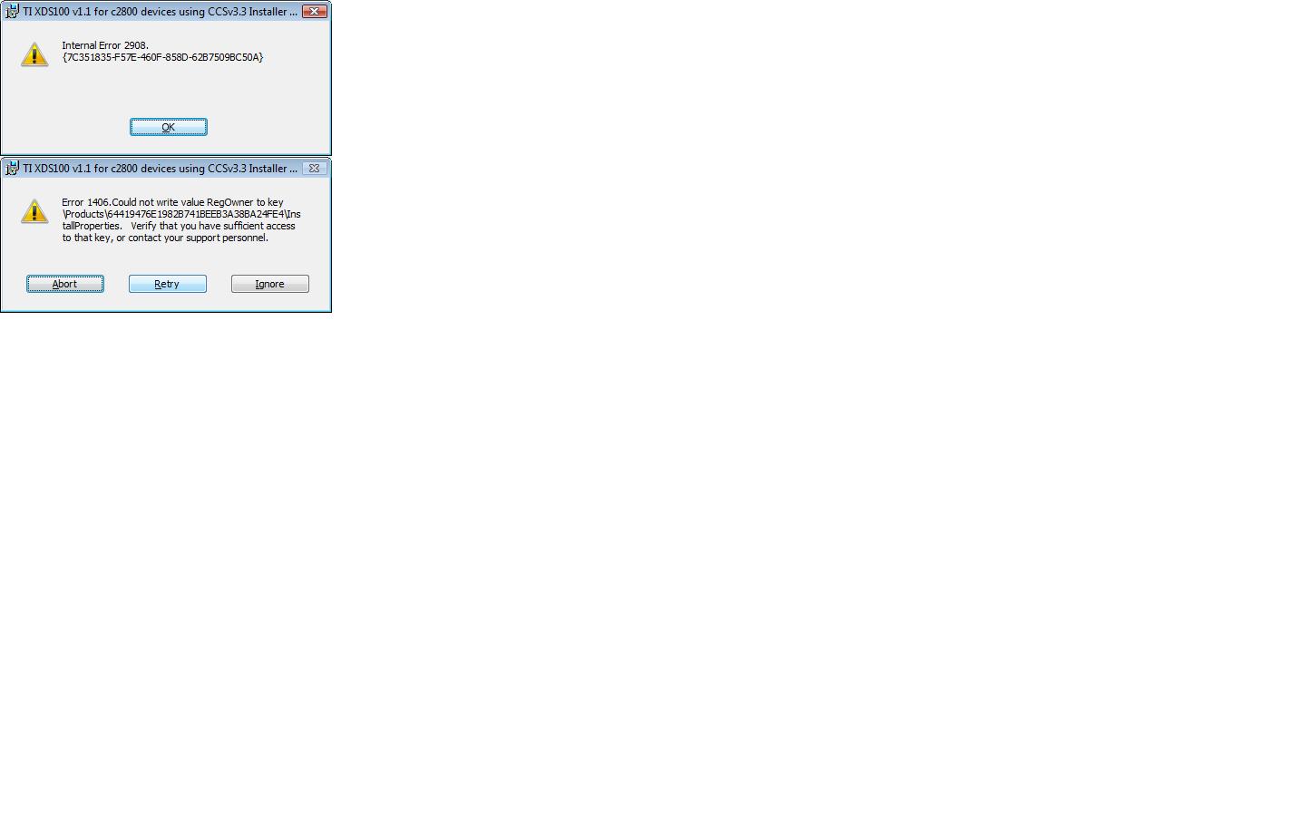

i am trying to install this as per instructions on here http://tiexpressdsp.com/index.php/XDS100#XDS100_Installation_Instructions
I keep getting internal error 2908 this error screen during the install followed by error 1406 screen snapshots attached i have to abort the installation,
I am using Vista 64 bit home premium SP1
Any help would be much appreciated, thanks
The first XDS100 driver release that supported 64bit was in CCSv4.0.2. I don't believe the software package for CCSv3.3 supports 64bit.
I have been able to use XDS100 with Win7 64bit fine.
