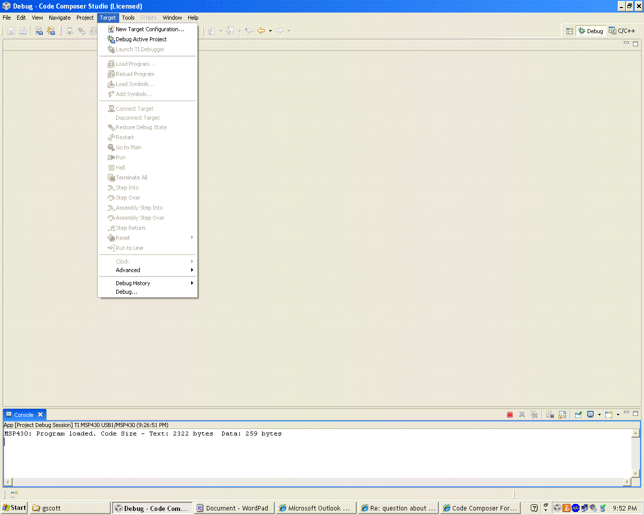

    The instabilities in v4.1.0.2003 are still an issue: I can switch between projects, select Target->'Debug Active Project', and then see the 'Erasing Memory' and 'Loading' progress windows come up.  After that happens, all the Target debug selections remain grayed out, such as Run, Halt, Connect Target, etc.  In addition, 'Launch TI Debugger' is grayed out, but 'Debug Active Project' is still selectable.  There seems to be no way to use the debugger once CCS goes into this state - very frustrating.  Are you aware of this issue?  I'll include a screen print in the next post.
  • CCS v.4.1.0.2003, after selecting 'Debug Active Project':
  • I've figured out why the Target options stayed grayed out: I had closed the 'Debug' view.  If I open the Debug view, the Target options become active.  If I close the Debug view, the Target options become grayed out.  In either case, it's apparent that the debugger is running, but with the Debug view closed, the debugger menu functions cannot be accessed.  Very irritating - please tell me that this behavior is not considered a 'feature' and that you will consider fixing this issue...

  • The reason for the the options being greyed out  is because there is no active debug context when the Debug view is close. This makes sense if you are working on a multi-core target and you need to specify which core has context in the Debug view. On a single core, you can argue that this should not be an issue. But it is a feature we inherited from Eclipse and in our ongoing efforts to comply to Eclipse standard, we will not try to deviate from this behavior.
