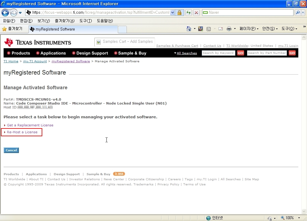

I got CCSV4 node locked single user(N01) license and activate it.
I wish to know limitation of "Re-Host a License" of CCS V4.
How many times possible re-host license ?

Hi Sang-il,
you can add a second mac to your license file and use CCS on two different machines (i.e. your notebook and your desktop PC).
Have a look at this posts: http://e2e.ti.com/forums/t/10857.aspx
So, if you intend working with two different PC there's no need to re-host the license again and again.
Rgds
aBUGSworstnightmare
I believe it is 2 times (might be 3, I will have to check wih IT) and after than you need to ping ccs_license_file_help@list.ti.com
The reason there is a limit is so that you can't create a pile of license files for different machines from a single activation code by simply rehosting the license many times.
