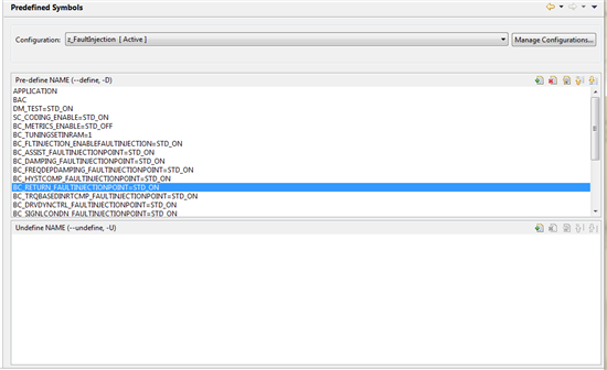

Hello Members, I have question about predefined symbol property of Code Composer studio.
I have some symbols defined to STD_ON in predefined symbols. And when i Build my project i do see one symbol source code lines are still grayed out even after defining to STD_ON in predefined symbols. Rest all symbols are working. Issue is only with one symbol. I checked for that symbol in whole project and its not defined anywhere else.
Any idea why its still taking it as undefined ?

    Please check below images. All other symbols which are defined are working fine and I defined in same way this symbol whihc is highlighted in below snapshot. But this is the only symbol which greys out always.

    In general, all files within the project should take the project level options by default. So without further details about your specific project, I don't know the reason why it didn't for this particular source file. Does the file have a push-pin like icon in the Project Explorer view that denotes it has file specific options? If so, it could be that those options were removed at some point. If that is the case, then you can right-click on the file, go to Resource Configurations->Reset to Default to set the options back to default project settings.
    http://processors.wiki.ti.com/index.php/Projects_and_Build_Handbook_for_CCS#File_specific_options
  • Yeah that file had specific file options. After doing Reset to Default it worked.
