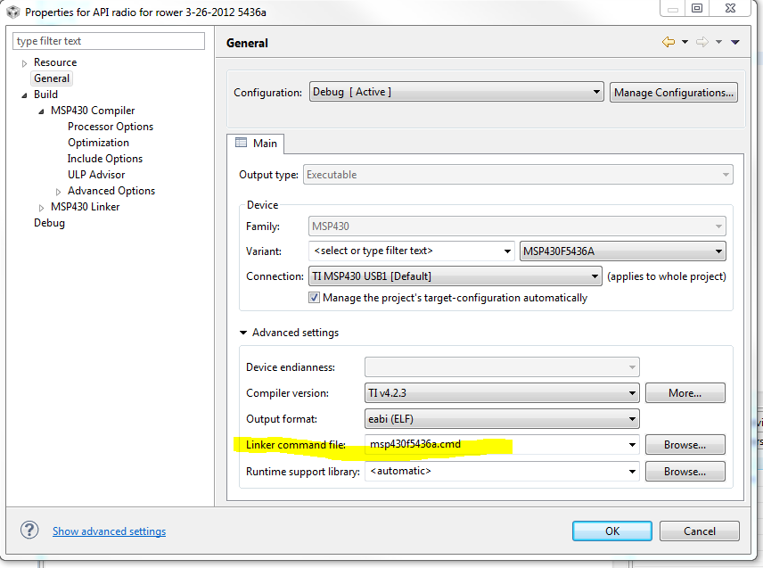

    Did you check the original projects these files were created? Basically all error messages (Data verification failed at address 0x00000200) indicate problems in writing to address 0x200, which does not map to any valid memory on the MSP430 devices you are using.
    A few details are shown in the wiki page below, but my guess is that you do not have a linker CMD file included in the projects you are building - thus everything tries to be allocated starting from address 0x0.
    http://processors.wiki.ti.com/index.php/Troubleshooting_CCS_-_Data_Verification_Errors

  • I think i have the proper linker file set.  is this what you mean?

    When the code is compiled, are there any warnings of the form "creating output section "<section_name>" without a SECTIONS specification".
    The reason for asking is that if the compiler version is updated, sometimes the compiler generates new section names which if not in the linker command file causes the linker to place code or data at an incorrect address leading to verification (or runtime) failures.

    #10247-D creating output section ".stack" without a SECTIONS
    Description Resource Path Location Type

  • i was able to find 4.0.2
    installing now.  will update
    However, i found an original linker file in the clients original folder structure and targeted that instead of the new versions CC5 is offering for my device.  and now 3 out of the 4 projects are working!
