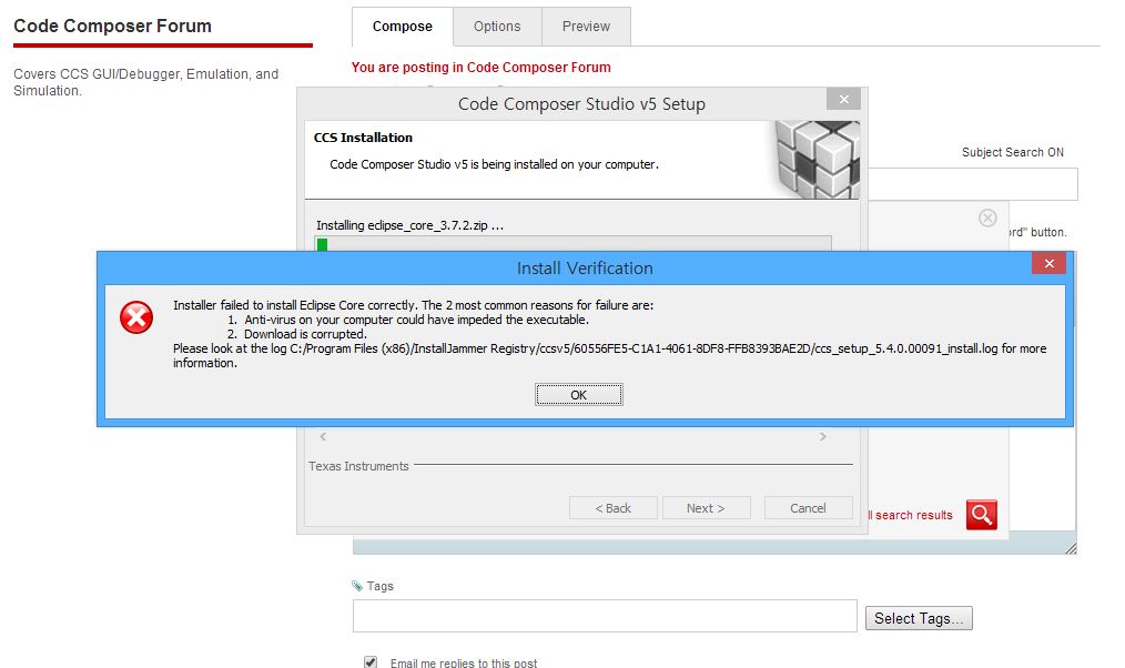

I've been trying to install ccs v5.5 for two weeks and I couldn't figure out what the problem is.
at first, warning message shows up, and it says"Installation detected pending reboot ~~~"
but even if i try right after rebooting my system, the same message shows up.
So I ignored them and proceeded. which lead to another error.
7776.60556FE5-C1A1-4061-8DF8-FFB8393BAE2D.zip
please help.
  • Hi Calvin
    I see two issues.  You have a user name with special characters and you are using program files.
    My recommendation.  Clear out all attempts including the logs.
    Then try with antivirus off and a different user account.   Also you may be better with the v6 beta and may not need a different account.

  • Okay, thank you for the advices.
    I just want to make sure about the word 'clear'.
    does this mean that just deleting setup file and remaining [c:\ti] folder won't be enough?
    Will I have to roll back entire system and change username?
    And by the way, TI should really think about issues involving OS in other languages.
  • Hi Calvin,
    I would make sure the user account has no special characters.  You should manually delete all the relevant folder and isntallation logs.
