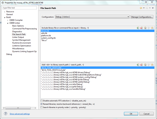

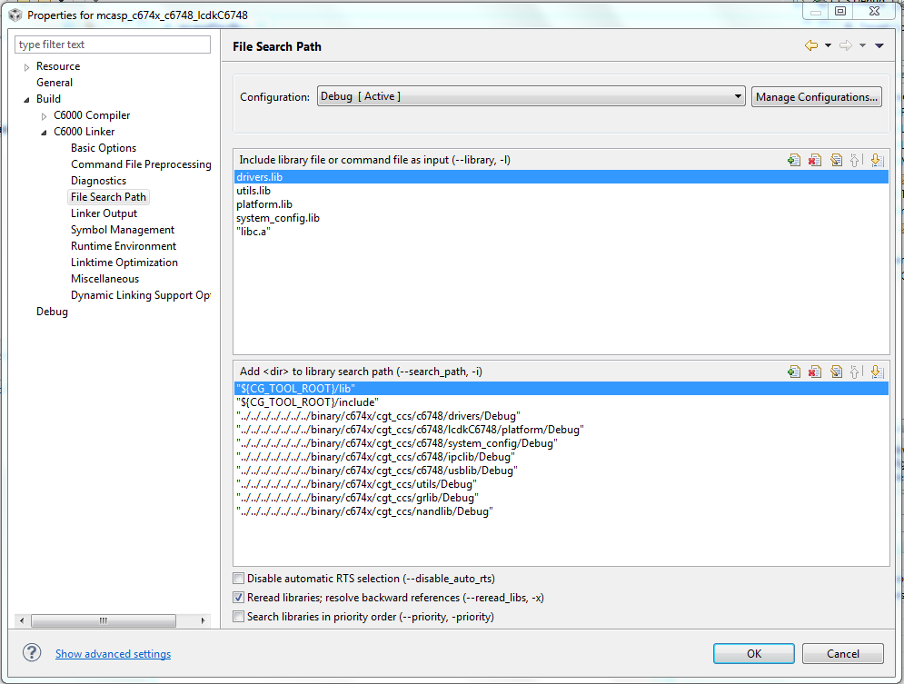

I'm having a problem with adding libraries to a project.  I'm new to CCS, so I'm trying to replicate an example project provided through Starterware in build.  The project links it libraries in the following way

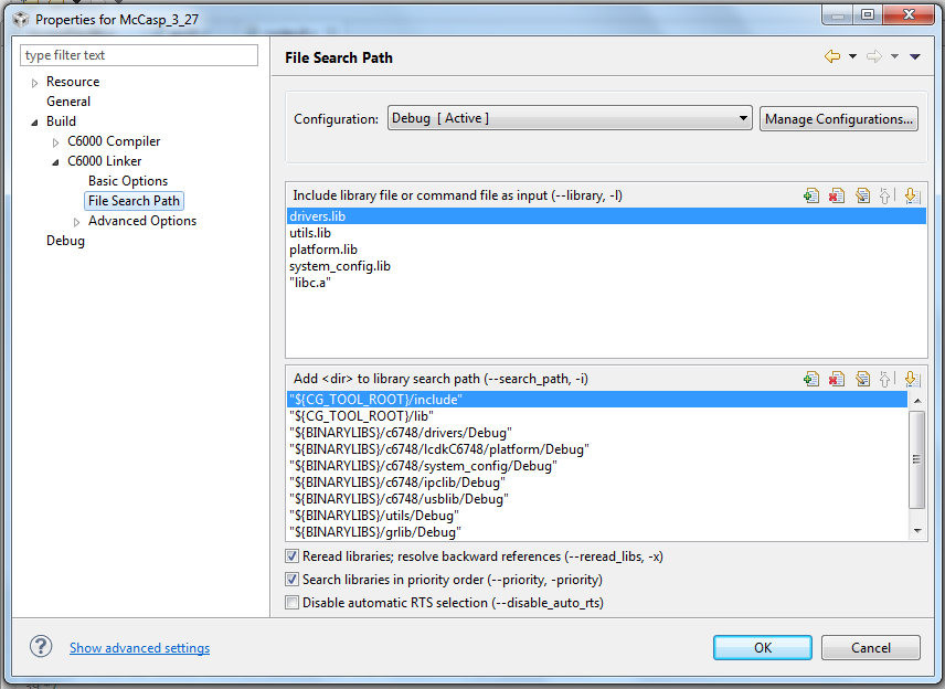

Here is my implementation in my project

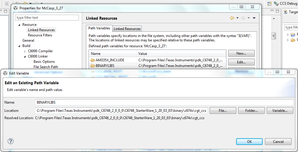

I was confused by all the "../../../"s, so I created a path variable named "BINARYLIBS", as each path stems from "C6748_StarterWare_1_20_03_03\binary\c674x\cgt_ccs".  After replicating the File Search Path with just that change, I am still getting the classic "unresolved symbol _" errors, which refer to every function called in the code.  I thought that the libraries I included would have contained these functions, but perhaps I am wrong?  The other way that I've found success in eliminating that error, is to hunt down every .c file relating to that function, and put it in the Project folder, but that's pretty tedious, and I know it isn't the correct way to do this.
Specifically, I am trying to recreate the project in "C6748_StarterWare_1_20_03_03\build\c674x\cgt_ccs\c6748\lcdkC6748\mcasp".

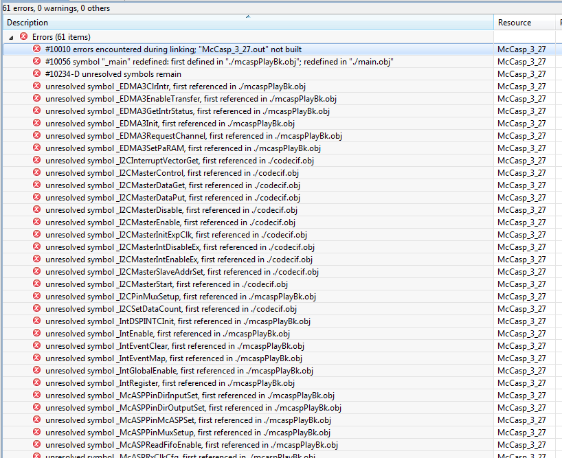

Here is the exact console errors that I'm getting
And the list goes on...

    I can tell from one of your first errors that you have main() defined in two places. This is probably because you copied in the example program in its entirety and also have your own main function. That does not work. You most likely will want to get rid of yours and work with the copy of the original.

    How did you implement your BINARYLIBS variable?
    Your BINARYLIBS variable is either implemented wrong or has the wrong value. These symbols would be found if the right path were given and the right name were given. Try editing one or all with full discrete paths in the search path window, then try to link again and see what it gives you.
    What do you see in the console output from the linker? Does it show the full path that is used or the BINARYLIBS variable name? This might help figure out where it is trying to find your libraries.

    I got rid of my main.c file and the corresponding error went away. Thanks!
    Now for the other erros:
    I implemented the BINARYLIBS variable in the following way
    Basically, I created a Path variable name in the Linked resource section.
    I also tried your suggestion of editing to the full discrete paths in the search path window. This also did not work.
    From the linker in the console output, I see the following warnings for all the libs:
    <Linking>
    warning #10373-D: library "C:/Program Files/Texas Instruments/pdk_C6748_2_0_0_0/C6748_StarterWare_1_20_03_03/binary/c674x/cgt_ccs/c6748/drivers/Debug/drivers.lib" contains ELF object files which are incompatible with the TI-COFF output file.  Ensure you are using the proper library.
    So I think I'm implementing the path variable correctly because it sees the full path in the linker stage.
