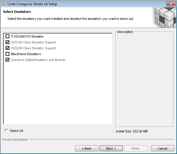

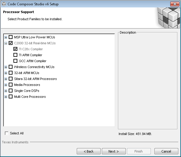

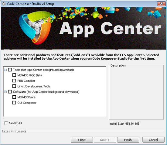

I re-ran the install. I didn't see a simulator option, so I didn't continue with the installationl. shown below are the option dialog boxes that were displayed during the re-installation.
Also, my company computer doesn't allow me to disable the virus scanner as recommended by the installation program. Could that be the issue?
Stephen
Sorry, I'm not really sure why it is not there. I assume you want to use the F283x CPU simulator.
Check the following directory:
<INSTALL DIR>\ccsv6\ccs_base\common\targetdb\configurations
Is there a file 'tisim_f283x.xml"? Do you have any files in that directory?

keystone simulators will show up in the App Center around next week. The rest of the simulators will not be available by default on the App Center. But v6 can be manually updated to have them. I'll provide more details later (when i get them)
