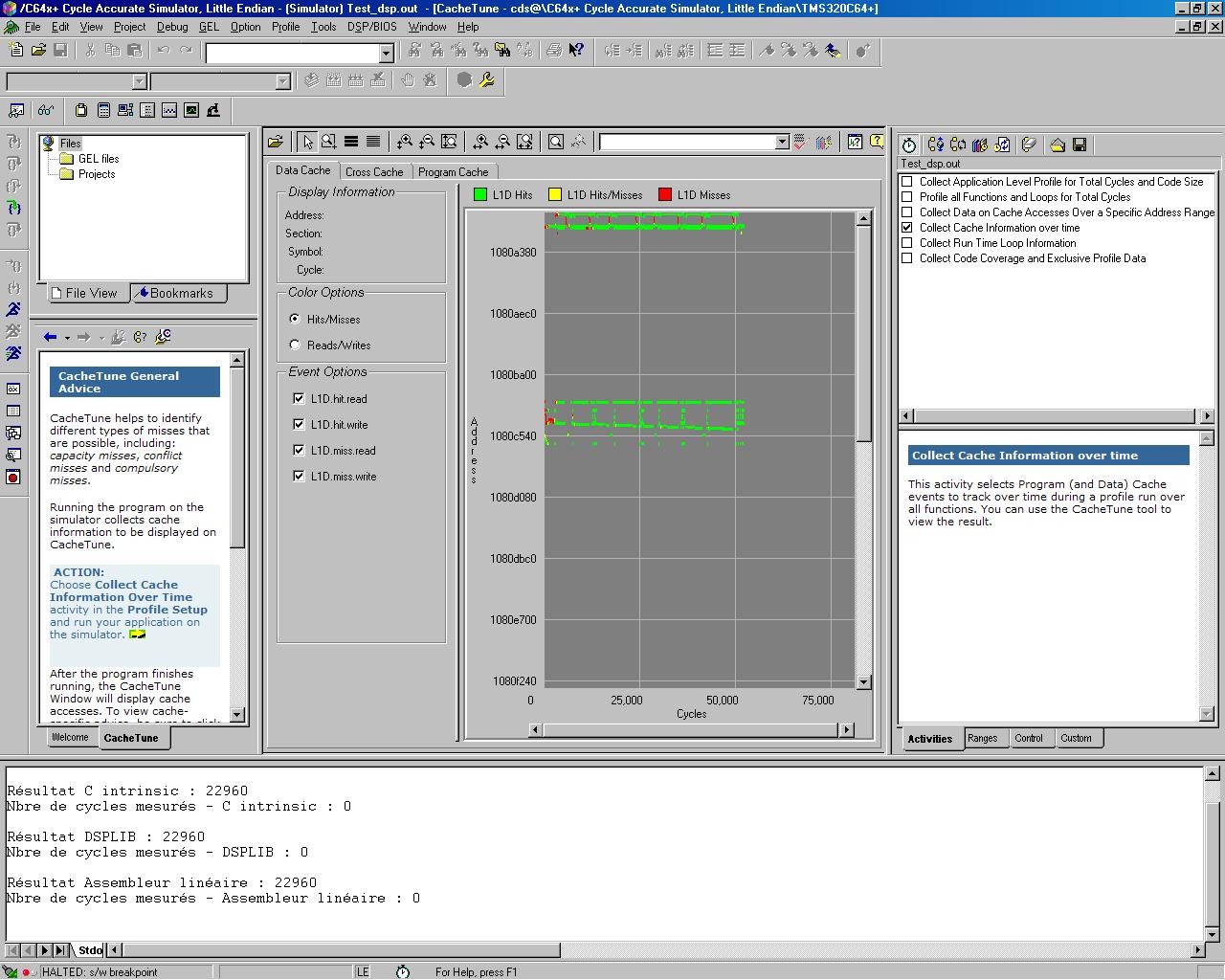

  • Hi Bubsy,
                The changes in the simc64plus.cfg file looks good and caches are getting enabled. (You can check that by clicking on tools->CacheTagViewerControl->CacheTagViewer)
    I ran you program and I am able to get data in cache tune without any crash. (My CCSv3.3 version - 3.3.82.9) May be you should try the version I am using.
    I have also doubt in the your steps to enable cache Tune. Please follow the step below and let me know.
    1. Bring -up CCS & load you program.
    2. Click Profile->Setup. Profile setup window will pop-up. In this window select "Collect Cache Information Over time"  & click enable profiling (clock symbol)
    3. Run the program to completion.
    4. Click Profile->Tuning->Cache Tune  (You should see some results)
    I have attached a snap-shot of the result I got.
    Mani
