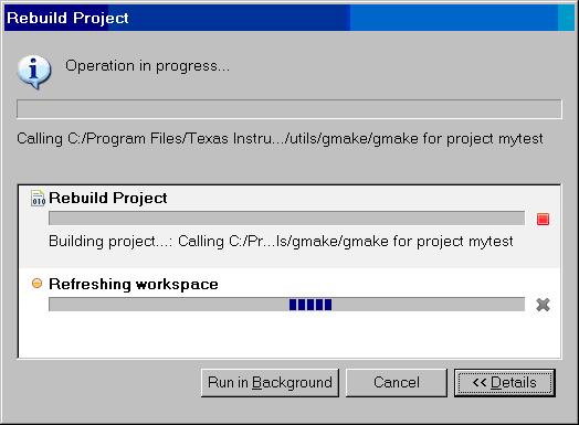

CCS 4.0 could not set the optimization level to 2 or 3
I tried to optimize my code in CCS 4.0 because the speed of the non-optimized one is slower than my CCS3.3 version. However, after I set the optimization level to 3 in the C/C++Build->Tool Settings ->Basic Options , during the Building procedure, the CCS4.0 was just stuck there and it never ended. I Open the details in the progress dialog and here is the screenshot.
 When I choose canceling the process, here is red-color feedback in the console window in the following.
 INTERNAL ERROR: C:\Program Files\Texas Instruments\ccsv4\tools\compiler\c6000\bin\opt6x.exe experienced a fatal internal fault while
                processing function _envelop_log_tight_loop file C:\\DOCUME~1\\FYang\\LOCALS~1\\Temp\\049283
This is a serious problem.  Please contact Customer
Support with this message and a copy of the input file
and help us to continue to make the tools more robust.
Terminate batch job (Y/N)?
^C^C^C^CC:\Program Files\Texas Instruments\ccsv4\utils\gmake\gmake: *** [src/envelop_log/envelop_log.obj] Error -1073741510
"C:\Program: Interrupt/Exception caught (code = 0xc0000005, addr = 0x4158e9)
Build error
(Command canceled)
Can anyone give me some help on this?
  • Such internal errors are usually the result of a bug in the tools, in this case the optimizer (opt6x.exe). Could you confirm if you are using v6.1.9 of the C6x compiler tools? You can check this under Project Properties->CCS Build Settings.
    If it is v6.1.9 you may want to try downloading v6.1.11 from the Update Advisor web site and see if the error still occurs, as the bug may be fixed in this version. Please check this page for steps on how to set up CCS v4 to recognize and use a different version of compiler tools: http://tiexpressdsp.com/index.php/Compiler_Installation_and_Selection
    If the error still occurs with 6.1.11, please zip up your project and upload the file to your forum Profile and update this post to let us know its there, or send the zip file to support@ti.com so the bug can be tracked and fixed.

    First of all, I was trying to compile my project with CGT v6.19 under CCS4.0.
    Then I downloaded the 6.1.11 and suddenly, my project can be compiled. This really makes me feel better. The major building optimziation settings include optimizaton level - 3 and optimization for speed - 5.

    As discussed, Aarti has your project now and will be looking into this. Here is an update on findings so far. Thank you for confirming that your original project was with CGT 6.0.8.
    The source file that hangs during compile is envelop_log.c when built with –o2 or –o3. I compiled just this one file on command line and can reproduce the internal error for CGT 6.1.9, 6.1.5, 6.1.3, 6.1.2.
     It shouldn’t matter whether it is CCS 3.3 or CCS 4 used to do the build. The build does complete with all the above versions if –o1 or lower is used.
    I also verified that it does build fine with 6.1.11 with –o2 and –o3 as reported. I need to track down a 6455 board to run the code to compare the cycle time. There were likely some changes in 6.1.x that might be affecting the performance of some routines.
