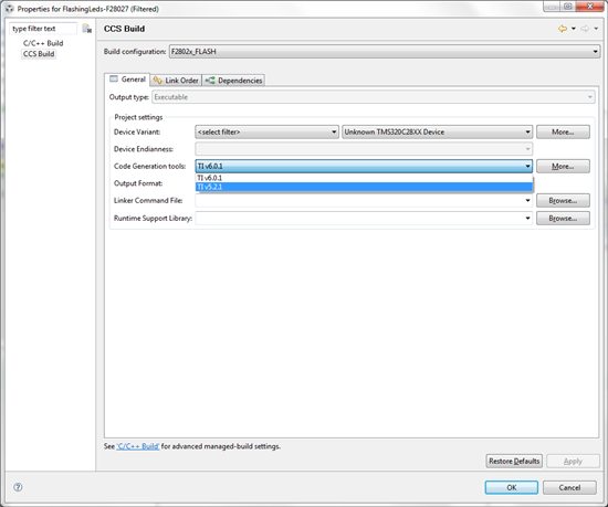

When I try and import the project I get the following pop-up:
I have no issues importing and running:
C:\ti\controlSUITE\development_kits\TemplateProjects\FlashingLeds-F28027_v1.0  (.ccsproject has the following <codegenToolVersion value="5.2.6"/>)

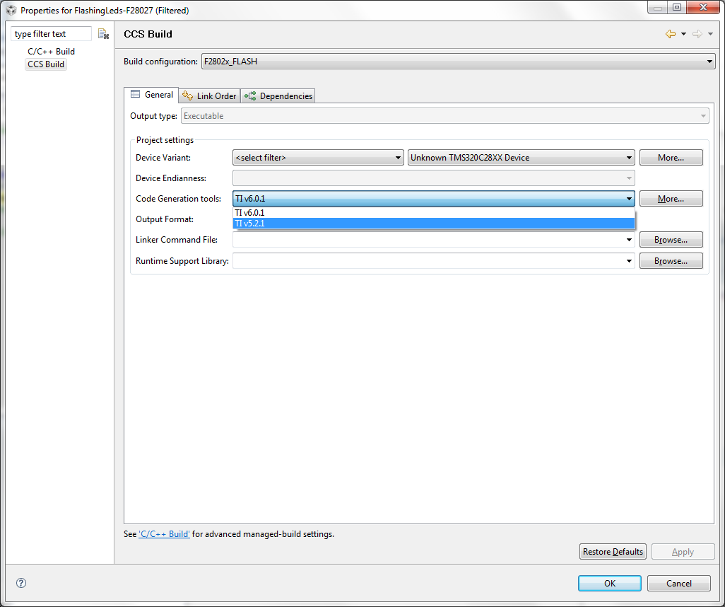

    Even though the .ccsproject shows the codegen tools version as 5.2.1, the .cdtbuild file shows that it is using build definitions from codegen tools version 6.1.0.
    However, I am able to import the project into my CCS 4.2.4.00033 with just a warning at build time (see attached screenshot). If you continue to have problems, try installing codegen tools version 6.1.x and then re-importing into a new clean workspace.
