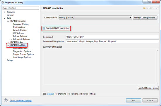

MSP430FR5739 device Project Properties > Build > Steps tab doesn't show Apply Predefined Step box.
Seems to be missing at least with new project and example projects from Resource Explorer.

  • Bill,
    The hex utility integration is different in CCSv6.  In previous versions we had created a rough integration utilizing a set of pre-defined post build steps.
    In CCSv6 the hex utility is now treated as a proper tool within the project.  If you go into the project options you will see the hex utility listed on the left.  You can then choose to enable it.  Once you have done that you have access to all the options available for the utility.
    John
  • Thank you John.  That's just what was needed, then tweaking MSP430 Hex Utility -> General Options -> Specify output file names to get a .txt filename.
