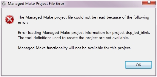

CCSv4 Managed Make Project File Error when importing Existing projects
Is there anyone saw this error before? How do deal with this? Hope for some helpful replies. Thank you!
    Which controller/dev kit are you using?
    Gautam
  • This error usually occurs when you try importing a project that used certain project build options or versions that do not exist with your CCS environment. For example, this could be a different compiler version or device variant id.
    Was a migration.log file generated?
