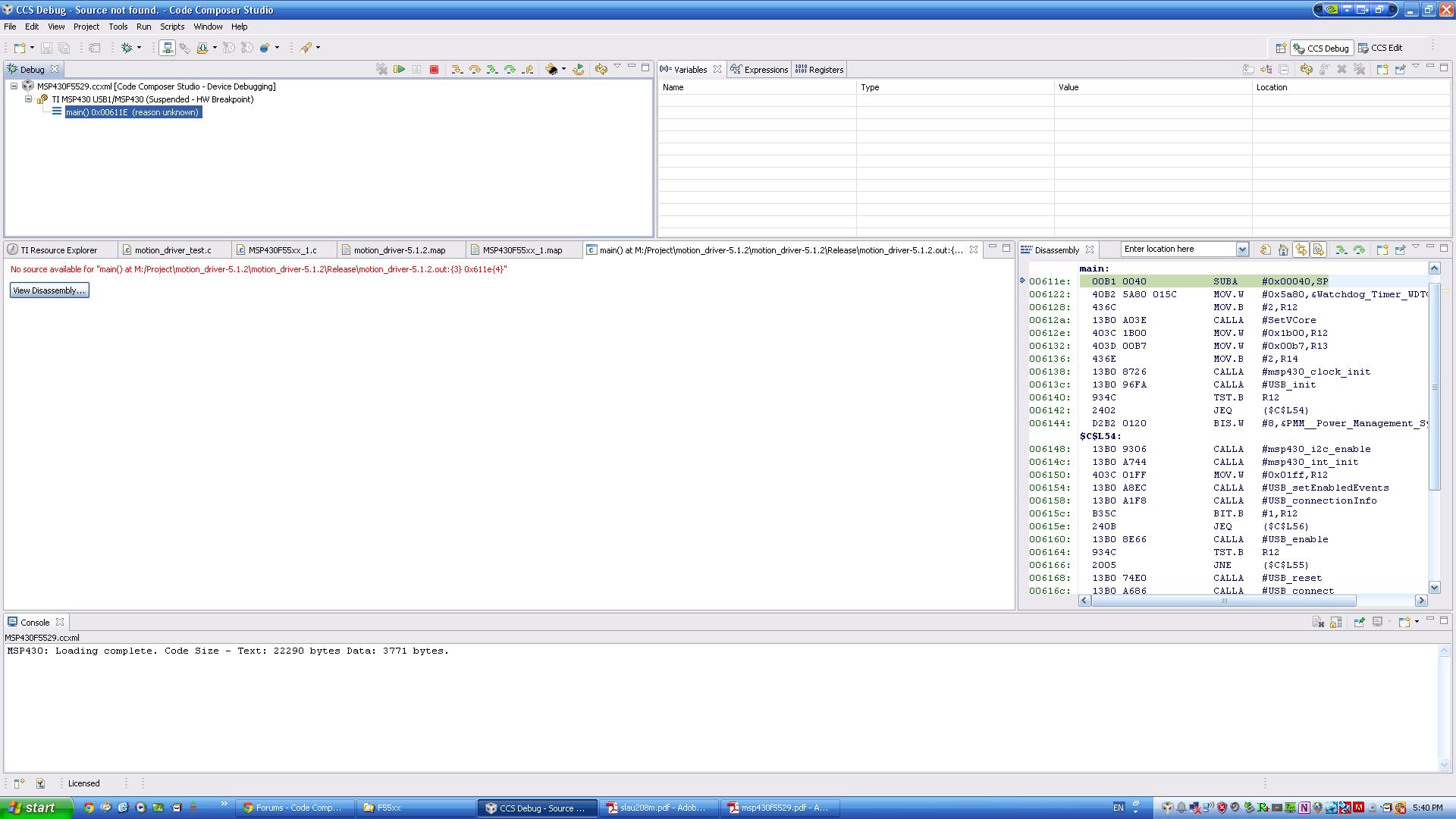

No source available for main()
Other Parts Discussed in Thread: MSP430F5529, TMS320F28335
I am using CCS 5.5.0.00077 on WinXP. I am testing out a project which builds without issues but when I run it, I get:
No source available for "main() at M:/Project\motion_driver-5.1.2\motion_driver-5.1.2\Release\motion_driver-5.1.2.out:{3} 0x611e{4}"
Can anyone give me some suggestions as to where to look for this issue? I have attached my linker file (this file came from MSP430 examples. Extension changed to txt.)

  • Gautam, the code does not run and I'm not sure where it is after I click on Run and Pause.
    Stephen, yes, it is in the map file:
                0000611e  local     .text:main (.text:main)
    I'm stumped at the moment as to what's happening.

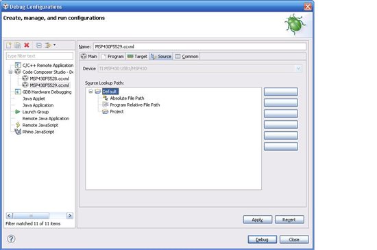

  • Also, the Debugger Source Lookup Path may be incorrect.
    You will find it at  Run->Debug Configurations and click on the Source Tab.
    Stephen

    I then use the same linker file on the same HW on the other project. Here is a screenshot of my Debugger Source Lookup configuration. I'm not sure what's the correct setting for this. It looks the same as the TI sample project.
  • It's empty???  That doesn't sound right.  Usually, I don't have to mess with it, but I thought that it might be the issue.  Are you debugging the LED sample project or just running it on the device.  I am thinking CCS doesn't have the location of the source files. That is why it can't find main() while you're debugging.
    From the source tab, try doing an add project (just click the add button then choose project) and select the project that you are trying to debug.
  • I added a project and tried running, but got same result. I am running in debug mode. It appears to be pointing to the right address (0x611e), but maybe that's not where the vector is? I remember there used to be a startup file, where did that go?

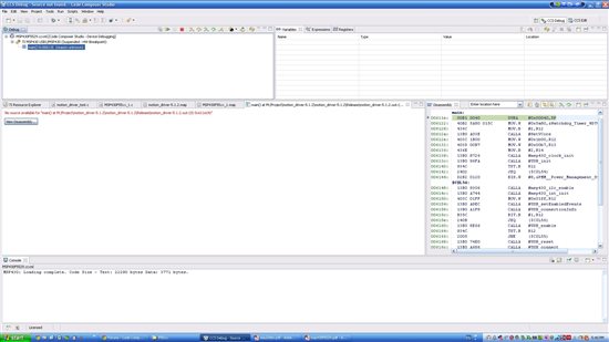

    The screen shows the program is halted at the first instruction in main(), which is the expected default behaviour when CCS is used to download a program.
    The CCS debugger is display a "View Disassembly..." button, but isn't displaying a "Locate File..." button. This suggests the source file containing main() hasn't been compiled with debug information.
    Under the CCS Project Properties -> Build -> MSP430 Compiler -> Advanced Options what is "Debugging Model" set to?
    The default is "Full symbolic debug (--symdebug:dwarf,-g)", but I was able to re-create your problem on an existing project by setting the "Debugging Model" to "Suppress all symbolic debugging information (--symdebug:none)"

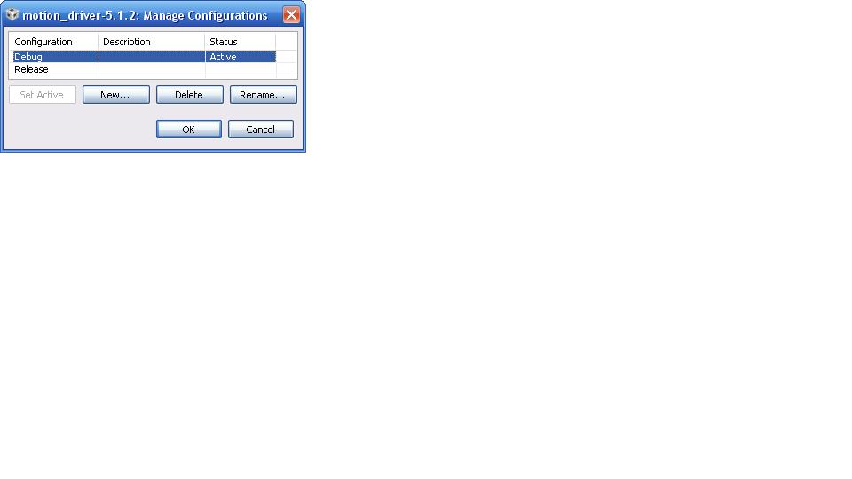

  • Chester is correct. This behavior is expected if the debugging model is set to --symdebug:none. Usually even in Release mode (which seems to be what you are building for), some skeletal debug information is still included, however if the option is explicitly set to none, then there will be no symbolic debug information.
  • When I try to create a debug build, after I click on OK, the dialogue box goes away but no debug build is created! Is it because some file is ready-only? I don't believe any of my workspace/project files are Read-Only.
  • As far as recreating the project using the LED project that I had that is working, when I build, I get this error:

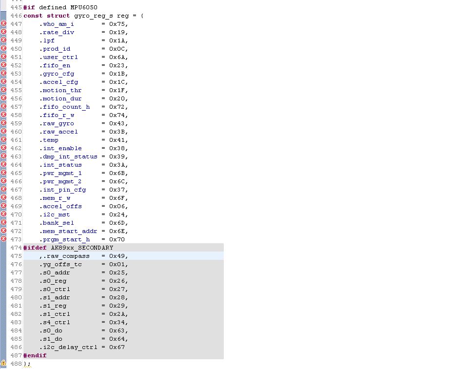

    #29 expected an expression - line 447
    At line 447 I have this struct declared:
    The definition of this struct is in the same file, so I don't see how it does not know what the members are. Sorry for my ignorance of C! This same file compiles and builds just fine using the original project, but does not run!
    That structure is using the GCC extension for Designated Inits. Therefore, to allow it to compile think that the "Enable support for GCC extensions (-gcc)" compiler option has to selected - under CCS Project Properties -> Build -> MSP430 Compiler -> Advanced Options -> Language Options.
  • Thank you Chester. That did the trick! I am now able to step through the code in the new project I created.
